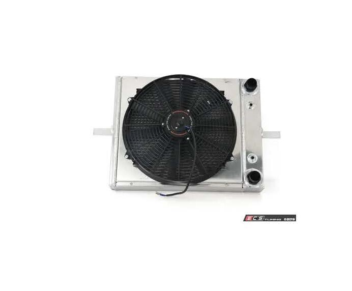

    I am looking for a radiator shroud/mount for an electric fan. All I can find available are mounting brackets for electric fans. I was hoping there was some sort of electric fan mount that has a full shroud or at least an electric fan mount that keeps the oem fan shroud. My mechanical fan and oem electric fan are both removed so I need something. Oil cooler is now where the oem electric fan was so no room for anything on that side. I was going to get the Chase Bays radiator that comes with a shroud and fan, but I noticed its not a direct replacement. Ended up getting a CSF radiator so I was looking for something like the Chase Bays radiator shroud/fan (see pic) that bolts up to a stock radiator. Worth noting that the car has a turbo, which heats up coolant and oil temps quickly. The car is not tracked so its only in boost for quick periods and also moving, so the heat from that usually is not an issue. More concerned about slow speeds like traffic or a drive through on a hot day with the A/C on.
    I saw something on a stock fan with and without a shroud, not sure what car, but the shroud made a difference. Obviously not a direct comparison so I am unsure how comparable it is to upgraded fans. Am I over concerned about the shroud and an electric fan on brackets just fine without a shroud?
    Regardless, if would prefer to keep the shroud if I could. Does anyone know of a company that makes something like this?
