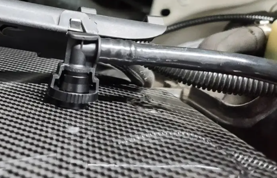

                  Did your air shut off valve also not seat nicely? The previous owner had the karbonius box installed but this line barely stays tight with the box. It definitely doesn't have a tight seal to the plug. Did you just drop them a note in [email protected]?
                  Pic is for reference and an old pic of mine where you can see the line not fully seated.
                    Looks like you had the exact same issue I did with that line. Mine wouldn’t “snap” in. Just email them and let them knows. They will make it right.
                        Mine did this as well, some light sanding on the shut off valve connector fixes it. I forgot exactly were I had to sand but I THINK it was on the little tabs that actually hold it in place, it didn't take much. Just look at it for a second and you'll figure out where to sand.

                          If you are going to modify the connector yourself, I don’t recommend sanding the plastic tabs. Karbonius recommends taking an angle grinder to the top of the metal connector on airbox side. You don’t have to take much material off. The top of the connector is too tall which prevents the plastic connector from engaging with the plastic tabs.
