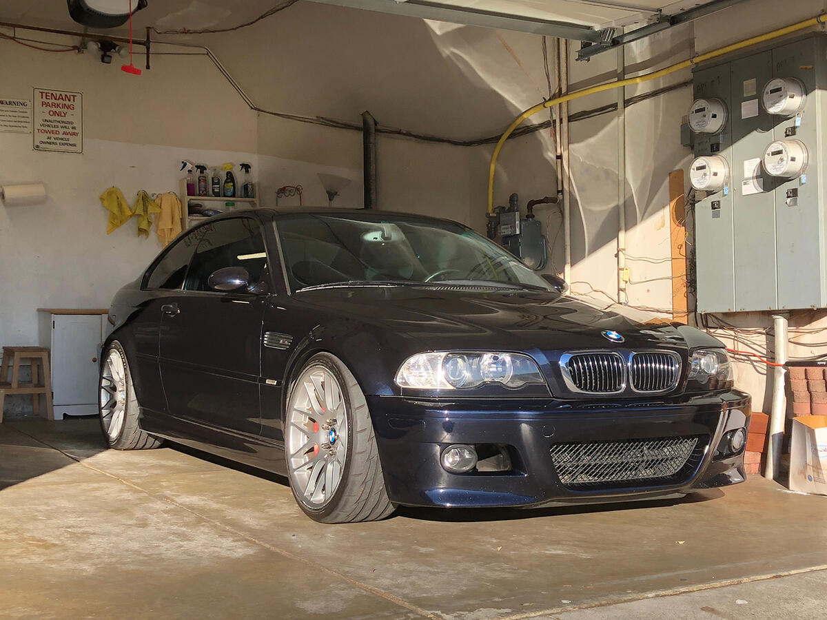

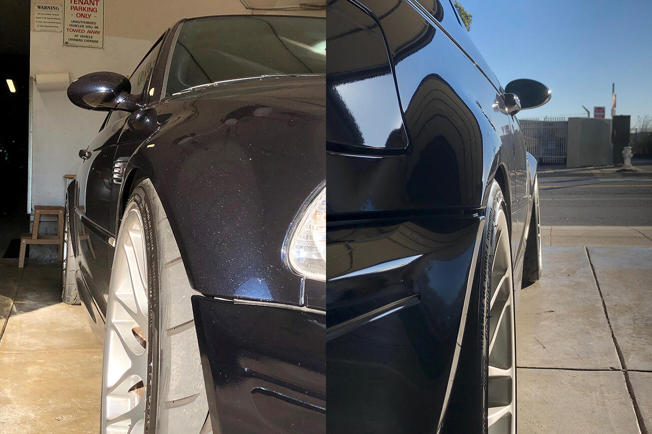

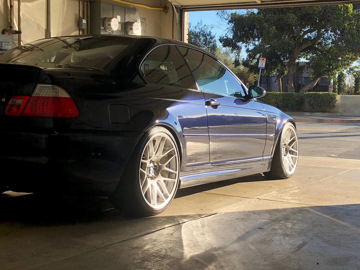

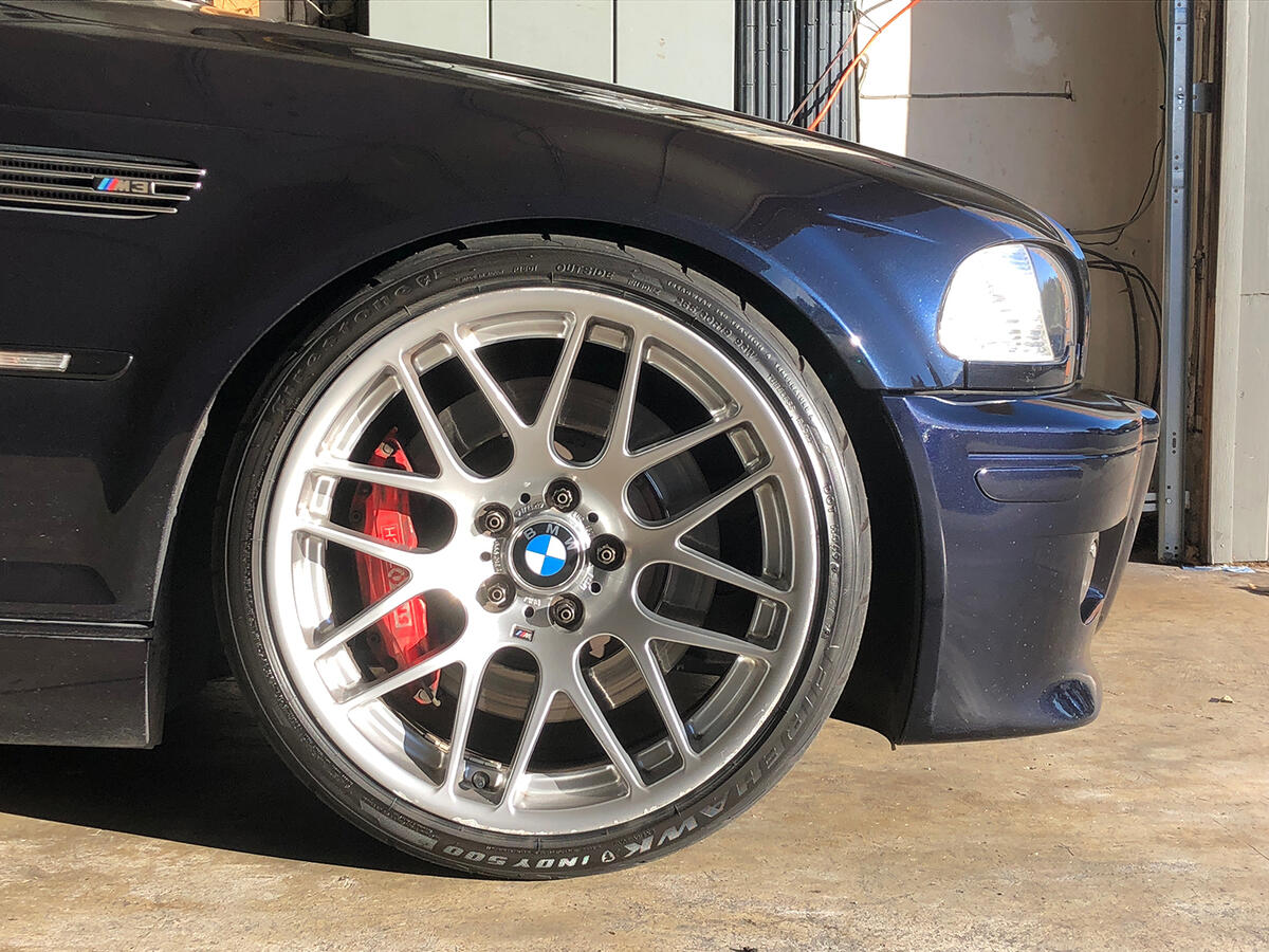

              Originally posted by BBB View Post
              Click image for larger version Name:	IMG_3816.jpeg Views:	0 Size:	171.5 KB ID:	74998​
              Click image for larger version Name:	IMG_3813.jpeg Views:	0 Size:	204.1 KB ID:	74999
              Click image for larger version Name:	image_18923.jpg Views:	5 Size:	170.5 KB ID:	74996​
              Click image for larger version Name:	IMG_3808.jpeg Views:	0 Size:	198.5 KB ID:	74997
              Couple notes - my garage floor is slightly uneven so the rear wheel gap is bigger in the pictures than it naturally sits. The top of the wheels do not poke front or rear either although it's hard to illustrate that in the photos.
