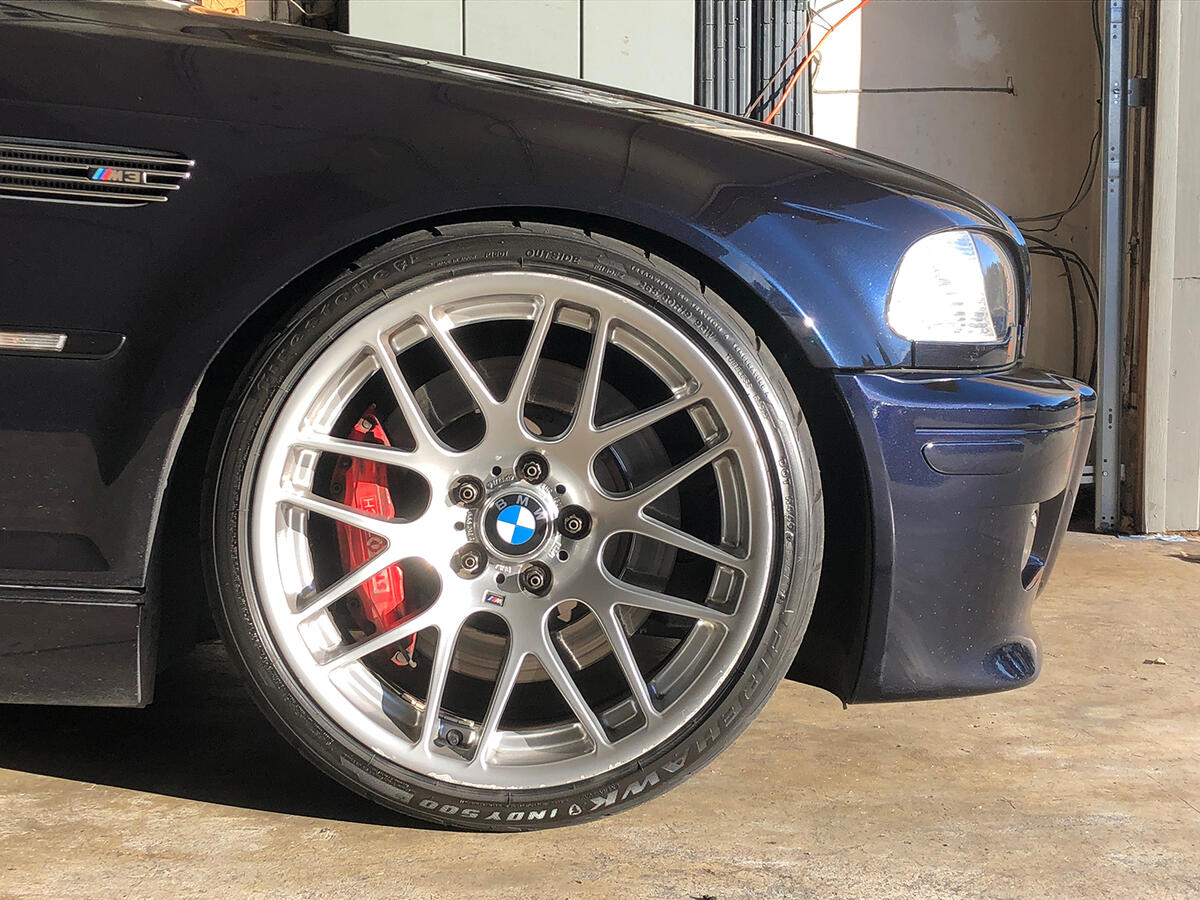

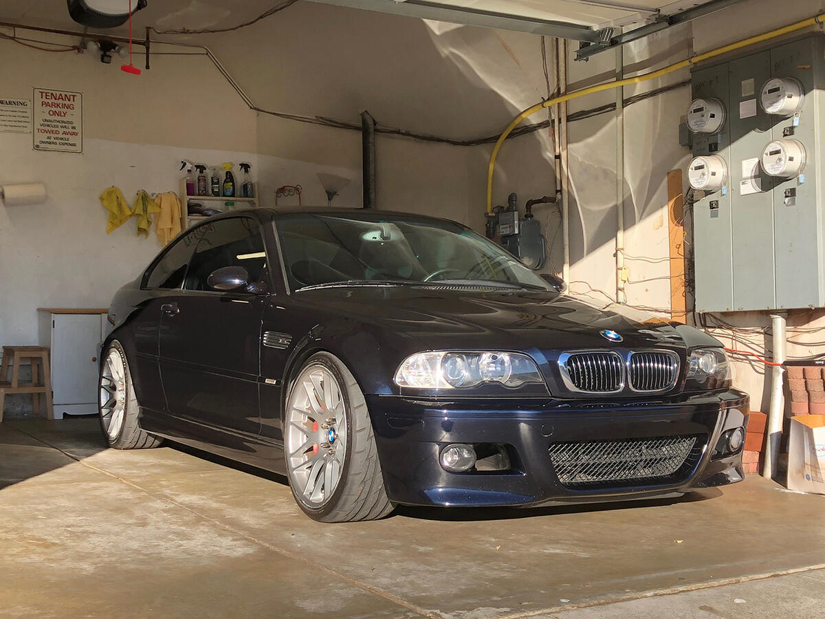

          I'm daily driving a square set of rear ZCP/CSL wheels with 265/30 on all corners (Firehawk Indy 500). I also have Stoptech ST40 front BBK (4 piston). I do not have any rubbing issues at full lock (parallel parking, tight U turns, etc). There is also plenty of front BBK clearance. My camber settings are -3 (front) and -2 (rear), and I also rolled the front fenders. No spacers up front, but I do have a 12.5mm in the rear. Hope this helps.

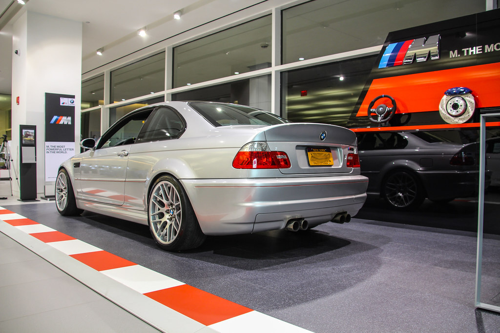

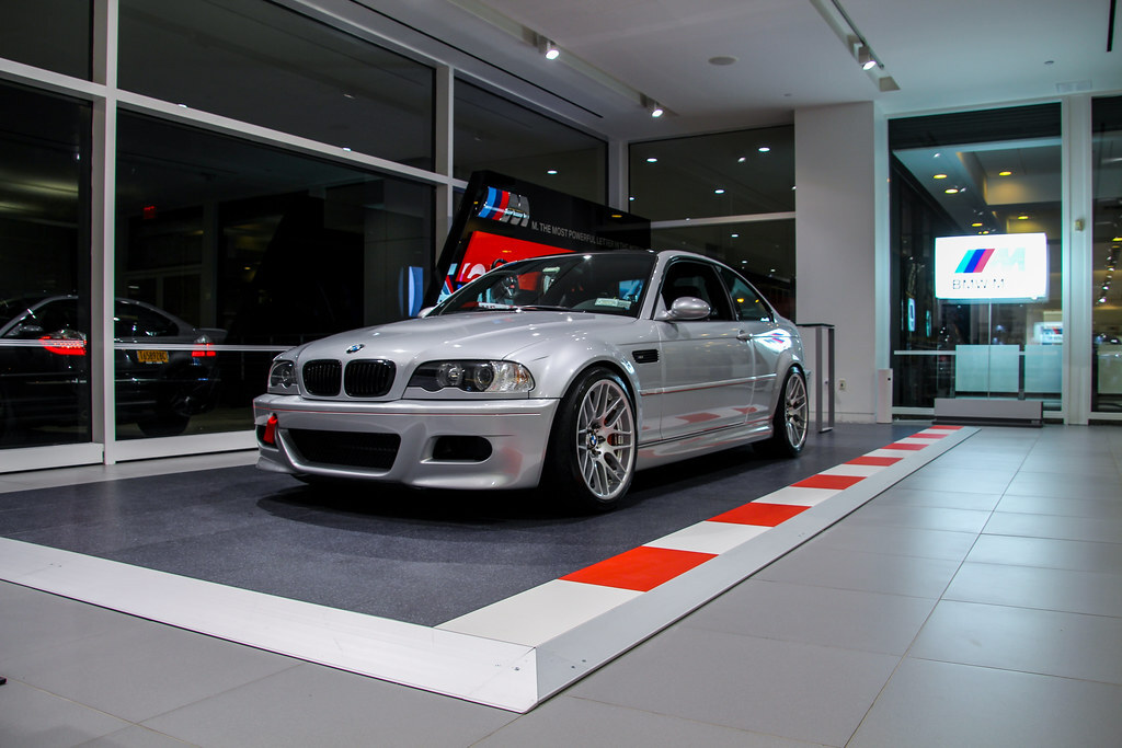

            I have also run square CSLs with both TCK DA and Ohlins R&T with to clearance issues. I ran 265/30 on all 4 wheels. Also no issues up front with BBK or 996 Brembos. You do need at least 2-2.5 of camber for it to look right. Agree with post above that another solution would be to machine the backpads if you want less camber. I thought they looked pretty good as is:
            This looks so good, are you running a rear spacer at all?
            '01 M3, Imola/black
              Yeah 10mm in the rear with cut fenders. On my street car with stock fenders I run a 7.5mm spacer.

                When I bought the car, the previous owner was running 265/35/18 on 18x9.5+25. Alignment shop showed -2.5 camber on that setup. The fenders were completely untouched. It did rub very slightly at full lock before I modified the fenders. 265/30/19 is roughly the same overall rolling diameter as 265/35/18 (actually 1mm smaller per willtheyfit).

                          Click image for larger version  Name:	IMG_3816.jpeg Views:	0 Size:	171.5 KB ID:	74998​
                          Click image for larger version  Name:	IMG_3813.jpeg Views:	0 Size:	204.1 KB ID:	74999
                          Click image for larger version  Name:	image_18923.jpg Views:	5 Size:	170.5 KB ID:	74996​
                          Click image for larger version  Name:	IMG_3808.jpeg Views:	0 Size:	198.5 KB ID:	74997
                          Couple notes - my garage floor is slightly uneven so the rear wheel gap is bigger in the pictures than it naturally sits. The top of the wheels do not poke front or rear either although it's hard to illustrate that in the photos.
                          Big Booty Betty - '02 E46 M3 Coupe
                            Those 19x9.5’s square setup looks so amazing on the e46 m3. You can definitely see the camber up front.
                            What suspension are you on?
                            Your on -3 degrees camber up front?
                            You think you would have problems with a wider Michelin PS4 265/30/19?
                              Thanks man. Yes, -3 front and -2 rear. I'm on some GC coilovers/camber plates that are on the way out. Can't speak for the PS4s, I don't have personal experience with them.
