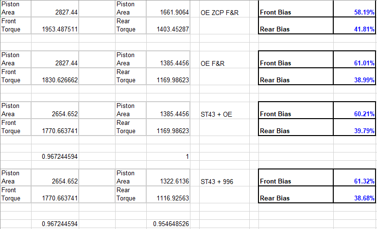

    Hey guys. I’ve been trying to get access to clawhamm3r’s brake bias calculator google sheet, but my requests to access the sheet have not been approved for over a week. I was hoping someone with access to it would be able to plug in some numbers and let me know what the bias is for a front StopTech C43 BBK paired with stock rear brakes and with a 996 rear conversion. Measurements for the C43 front kit below..please let me know if you require more info.
    38/44 mm pistons
    332mm rotors
    50 mm or 43 mm radial pad depth (two options, prob will go with 50)
    Thanks

    I made a copy awhile back and I can share it with you and you can copy it to your drive. I think I inputted everything correctly here:
      Do you have a ZCP or Regular M3, MK20 or MK60?

        This is what I estimated for the different setups you have in mind

                Thanks for sharing. Looks like 996 wouldn’t be ideal.
