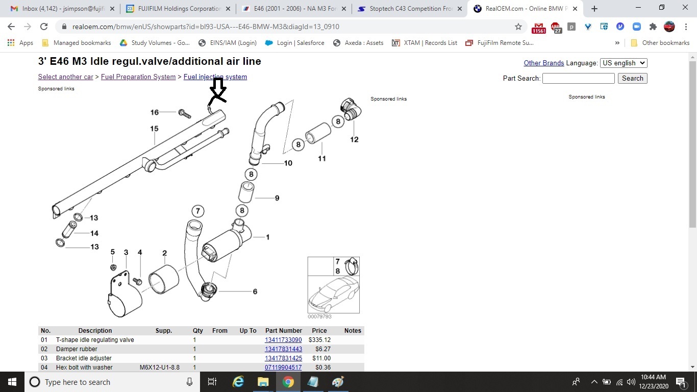

ID:	75016Anyone know where the vac line reference ends. I just finished my intake install only to see it was disconnected and I would rather run a new line if possible than take off the box. Thanks
    Jeff
    It connects to another hose that is behind the airbox. Check to see if the longer hose has fallen down
      Any chance you know where that hose terminates? I can see the other hose but cant get to it without risking scratching the carbon it got pushed way down there. Thanks
      Jeff
        It goes the the fuel pressure regulator that's under the car by the fuel filter iirc.
          ^ Yes
          Youtube DIYs and more
            Fantastic that is what I was hoping for. Thanks all
