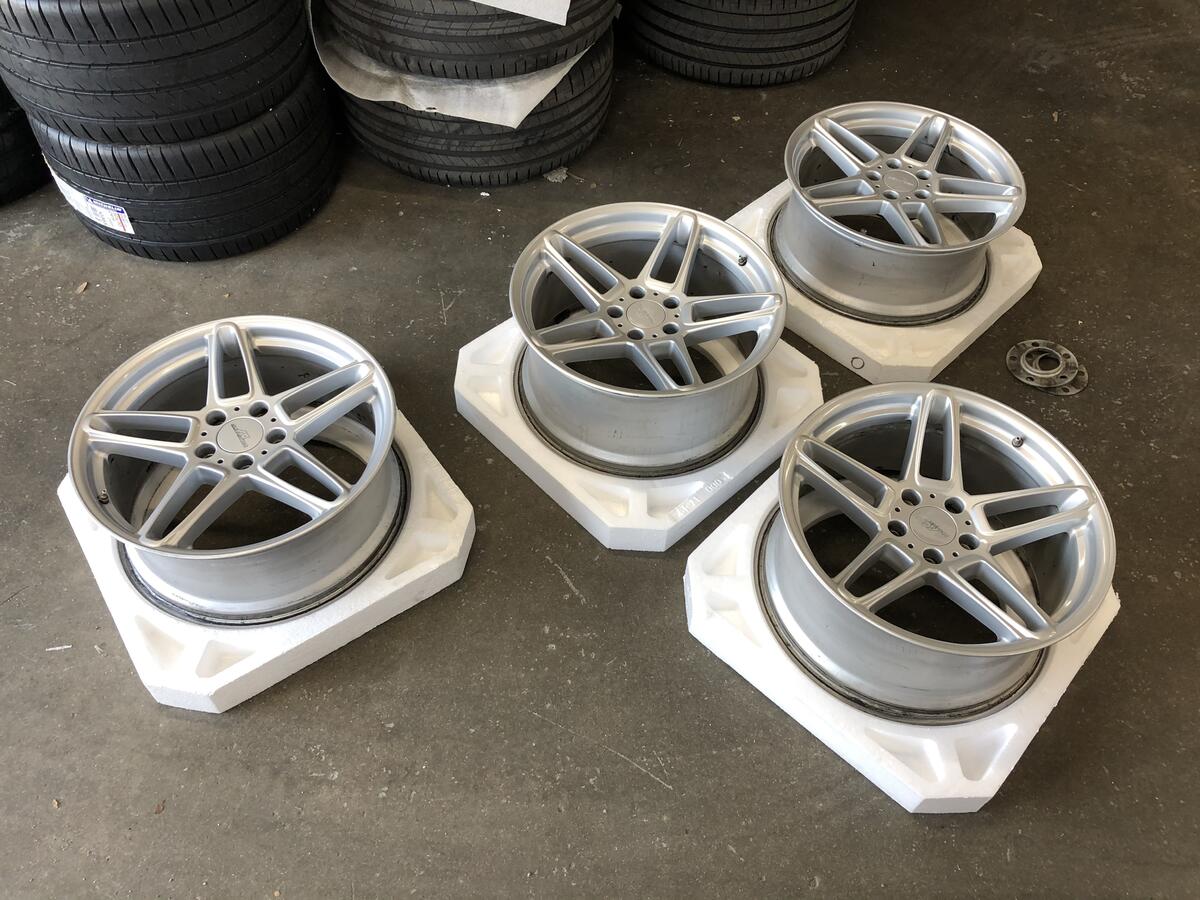

                            Side note, copped a nice set of staggered 19" AC Schnitzer Type 3s yesterday. Got a great price on the wheels I'd been hunting for a long time and they're pretty clean to boot!
                              Awesome. Those wheels are on my top 5 list all time. Still looking for a nice 2 piece set.
