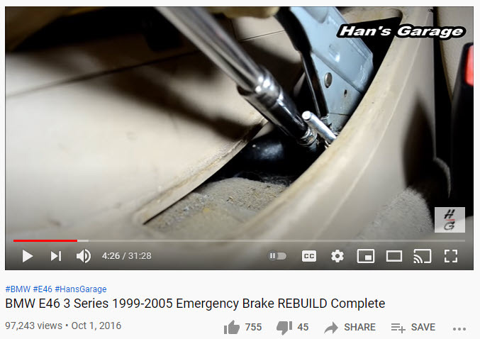

              Also found this good DIY video about disconnecting the lines with 10mm socket.
              I'm thinking that once disconnected these lines will not just drop down to the bottom of the car...

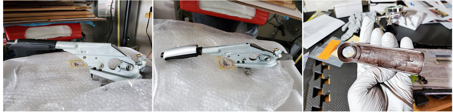

                I thought so too, but the handle on this Z8 ebrake will just not come out.
                As i said above, i'm kind of stuck with this now.

                      Yeah— it’s been 15 years, but IIRC that’s how I did it.
                        Took a while to get the whole lever replaced. I gave up on just swapping the handle.

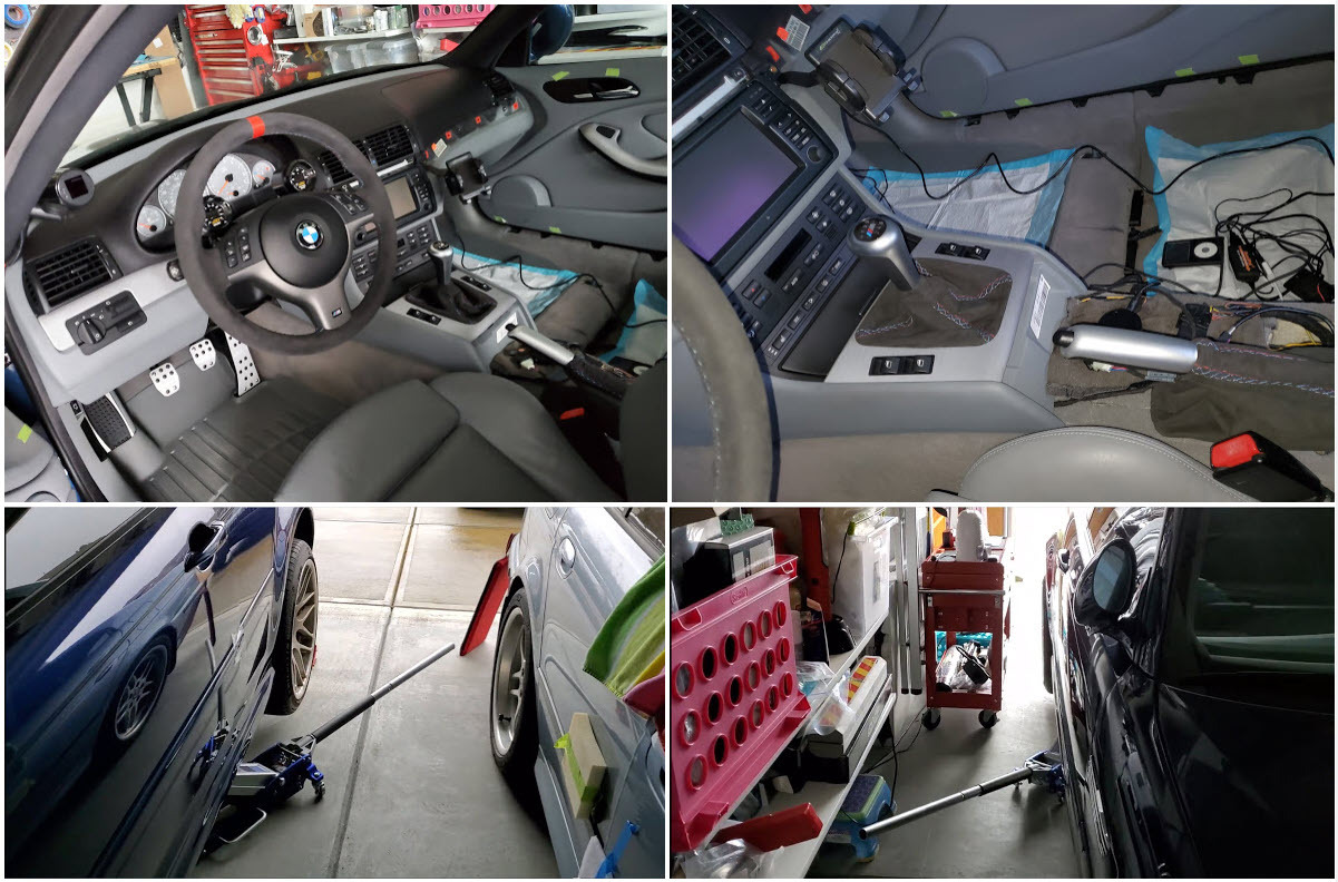

                        Don't look too bad...
                        In addition to the above, when you are re-installing the nuts make sure to tighten them correctly such that the handbrake is adjusted properly. I think the BMW spec was 1 click/free wheel, 2 clicks/resistance at wheel, 3 clicks/locked wheel (when on jack stands). The proper-proper way would be to adjust the shoe-pivot point first, but IMO not completely necessary if you don't want to as there should be enough threads at the ends of the cable to compensate if that adjustment is a bit off.
                        It would suck to run the nuts down too much such that you were unknowingly dragging the shoes on the rotor, or wrap everything up to find out that your handbrake no longer holds the car.
                        Used pair of floor jacks to get both rear ends lifted (LSD... ) while adjusting the nuts. The nuts after tightening seem to hold the car, but i got tad bit loose for the 3 clicks. I would rather not have the shoes dragging on the rotor at 0 click. Will get this looked at when the car is at local shop for March dyno day.
