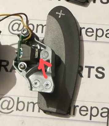

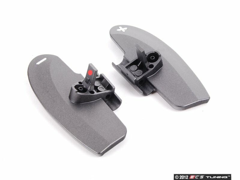

        Any idea what the bracket is made out of? If it's magnetic, you could add a magnet to the paddle tab that pushes on the button.

        There's probably not enough space for a magnet between the tab and bracket, but you could just recess it into the tab by drilling a small hole here:

        You'd want to make sure the magnet is in direct contact with the bracket when in the unpressed position for the most clickiness.
        Actually, even if the bracket isn't magnetic, there's probably enough space to attach a thin piece of metal to the bracket so that the magnet has something to grab onto. If not, you might need to recess that into the bracket. Just be careful not to use a magnet that's too strong, otherwise it might end up damaging the tab on the paddle over time.
        The switches would still perform the same, but I would imagine that the feel would improve substantially. It would require slightly more effort to press, but the paddle would firmly latch in and out of the unpressed position. Very similar idea to what's shown in this video:

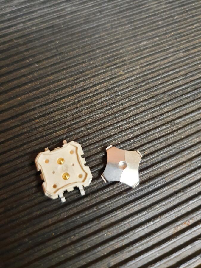

                  If you open up the switches there is a pressed steel /tin plate that sits on the switch assembly. This can fatigue with age and even split as mine was. You can replace this piece from a new switch that cost a few dollars and it restors the paddles possitive clicks when you flick through gears. I will try find some pictures of my switches.
                  You can see the crack in the metal plate. I was going to replace the complete switch but found just that piece the problem. Now I get good positive feel from the paddle

                    +1 to what ClevoCapri said.
                    I, too, had that mushy feel and was already leaning towards getting entirely new switch assemblies. However, I tried disassembling the switches themselves and got to the tin plate and noticed that it was almost practically flat. If you carefully bend it again to be more dome-like and them reassemble the switch, the positive, clicky feel will return. The tin plate acts as both spring and contact.

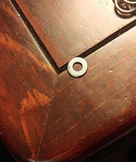

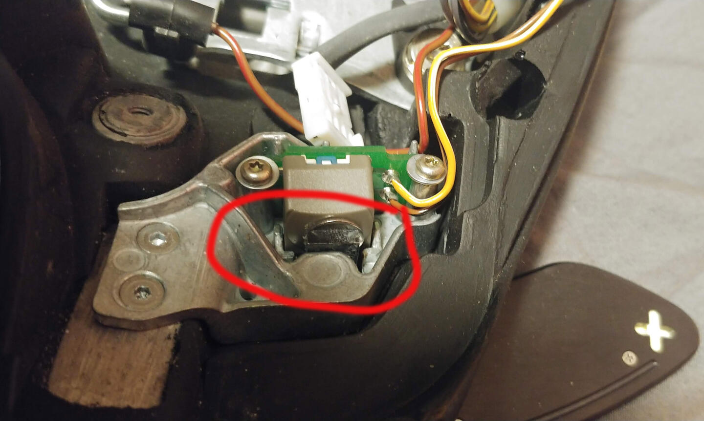

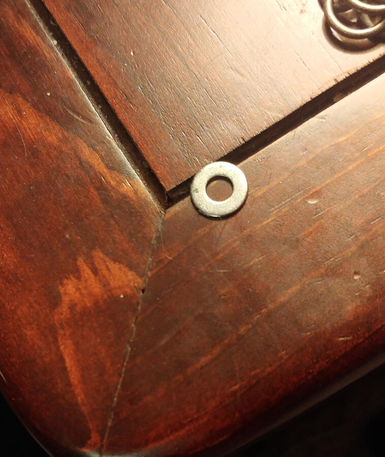

                            Here's my solution.
                            If you take a look between the plastic cap on the microswitch and the arm that comes off the SMG Paddle, there is a fair bit of gap. To add to this, the plastic cap needs to be pressed down a small amount before the switch is activated. This is like. 2-3mm (if that) of travel, but feels really long and mushy when you pull the paddle. So I went to home depot an picked up some washers. Can't remember the size but I think maybe m4. I glued the washer to the top of the plastic cap from the microswitch using some e6000. The washer was not only thick enough to remove the dead space between the paddle and the switch, but also add some "preload" to the switch so that the amount of travel before the switch is activated is reduced and nearly eliminated. This Made a huge difference for me, not bad for ten cents worth of hardware. I had storm SMG Paddles which also helped a bunch, but for the sake of science I swapped my stock paddles back in to see what the difference was like. It was still miles better. Hope this helps!
