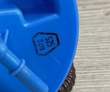

    For those wanting to baseline their cars and are curious of the fuel pumps date. Most are familiar with the obvious month and year stamp. This can easily be smeared or rubbed off. Although on some pumps it has survived.
    Brand new sample photo on ECS for a Genuine Pump.
    Click image for larger version  Name:	image.png Views:	0 Size:	65.4 KB ID:	325068

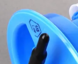

    Survived on an Original:
    Click image for larger version  Name:	image.png Views:	0 Size:	117.0 KB ID:	325069​

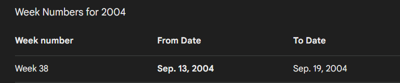

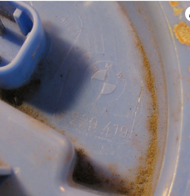

    For context my car was a 10/04 and I had quite a bit of grime, so I am pretty positive this is the original pump. I was able to notice this on my original pump. A stamped number which looked like a tire date code week of year and month. 38.04
    Untitled by Sam DaJam, on Flickr
    The other label says 09.04
    Click image for larger version  Name:	image.png Views:	0 Size:	15.8 KB ID:	325072​

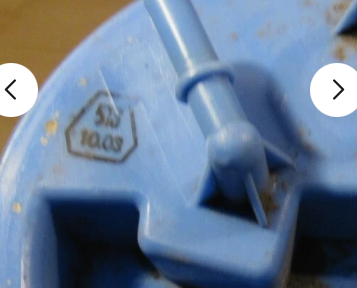

    For a sanity check went to an ebay listing:
    Ebay Listing:
    Click image for larger version  Name:	image.png Views:	0 Size:	635.5 KB ID:	325070
    Click image for larger version  Name:	image.png Views:	0 Size:	135.6 KB ID:	325071​
    https://www.ebay.com/itm/283788881104​
    So lets see if the 41th week in 2003 is in October.

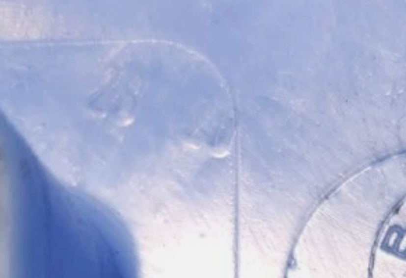

    My spare pump I have had this whole time doesn't have the paint mark with the month and date but the stamped mark says 2016. So I think I can presume it is a 2016.
