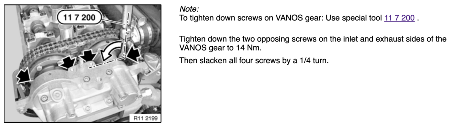

                Follow Tis instruction on how to pretension the hub: torque those 2 bolts to spec, then back out 1/4 or 1/2 I forgot, but it’s in the book. You do this with the spline shaft 1/3 inside the hub but no Vanos mounted, and so you can use torque wrench. Beisan instruction has the spline shaft connected to the Vanos, then insert spline shaft into the hub, and I don’t like it bc you cannot use the torque wrench!

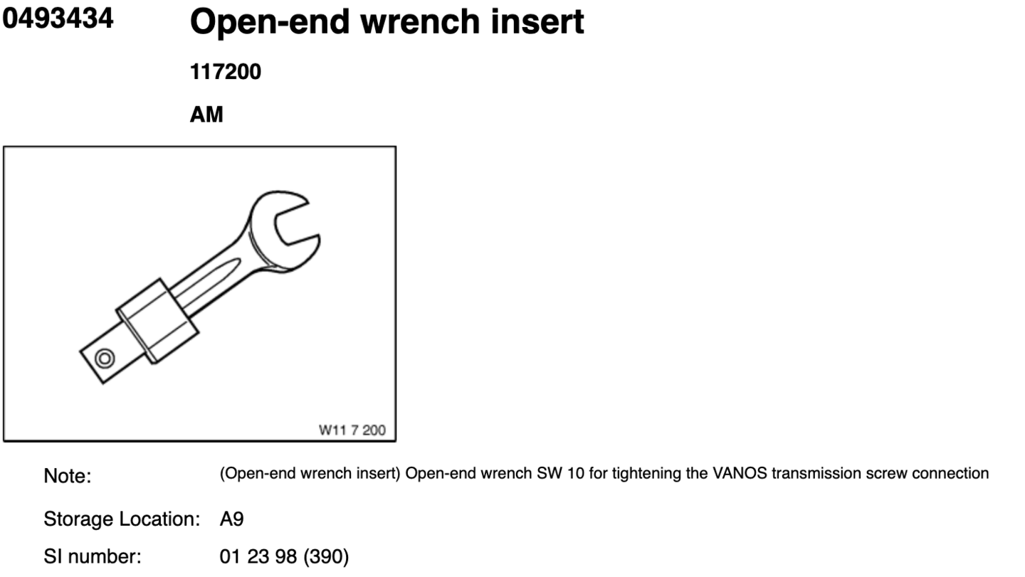

                      If you're really worried about getting the torque right you can get a set of crowfoot wrenches. The Harbor Freight version is probably good enough for this job: https://www.harborfreight.com/7-piec...set-94427.html
                      Using a crowfoot wrench is actually how TIS says you should do it:
                      Click image for larger version  Name:	Screen Shot 2021-01-11 at 4.40.34 PM.png Views:	0 Size:	254.8 KB ID:	78484
                      This is the 117200 special tool:
                      Click image for larger version  Name:	Screen Shot 2021-01-11 at 4.40.48 PM.png Views:	0 Size:	55.6 KB ID:	78485
                      Just keep in mind that this will change the length of your torque wrench, so you'll have to do a little math to know that to set your torque wrench to in order to get the correct torque at the bolt. Found this calculator that does that for you: https://www.tekton.com/how-to-accura...rowfoot-wrench
                        If you keep the crowfoot at 90 deg angle on the torque wrench it will not affect the torque value by any meaningful amount.
