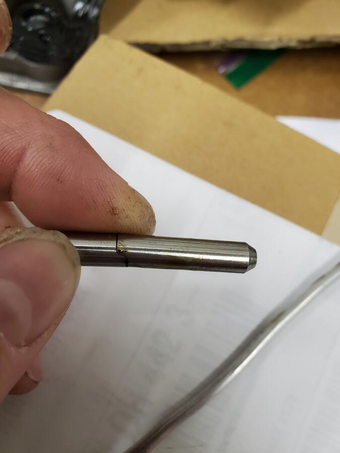

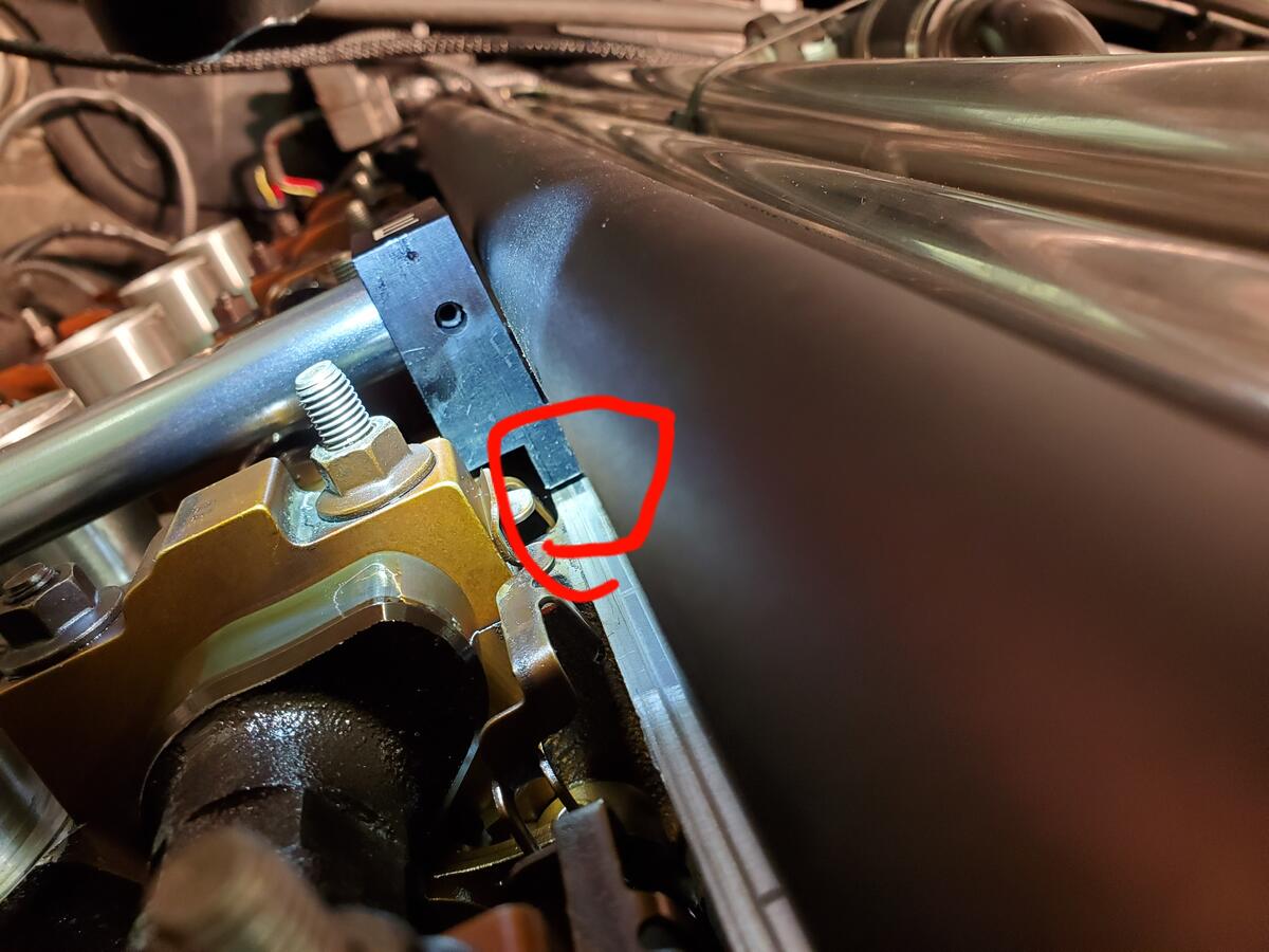

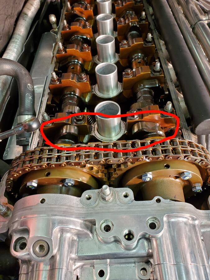

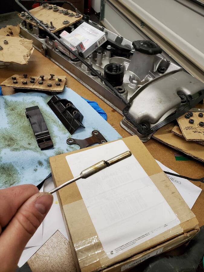

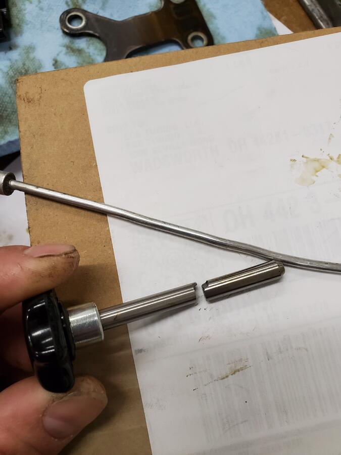

      Holy shit, bendy magnet 2nd try from the hole it went down! It looks to be fully intact as well.
      I lucked out in that I believe the piece was in the portion of the pan I have circled in red and with it being so big probably didn't move very or maybe even stayed upright.
      On a side note I want to apologize in advance as now I am nervous and after VANOS install my exhaust cam ended up being out of time according to the timing tool, it lifts about 4mm up off the intake side of the head. I'll surely be asking a bunch of timing questions now and posting more pics etc etc.
      Thanks for all your help guys.

        #48
        Congrats! It was where you thought it was the whole time.
