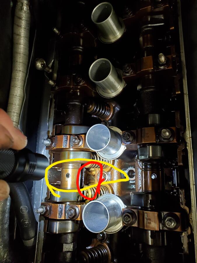

            #35

            You must believe. I think it’s not uncommon to drop a shim and then the tech can’t find it and move on. I’ve torn down a couple of S54s. I found an extra shim in the head in 2 engines.
            I sure hope your right! I do trust your experience over mine and will make a very concerted effort in the head area before moving on.
            Its just that that cam hole is 100% in line with the hole that the grate broke over.

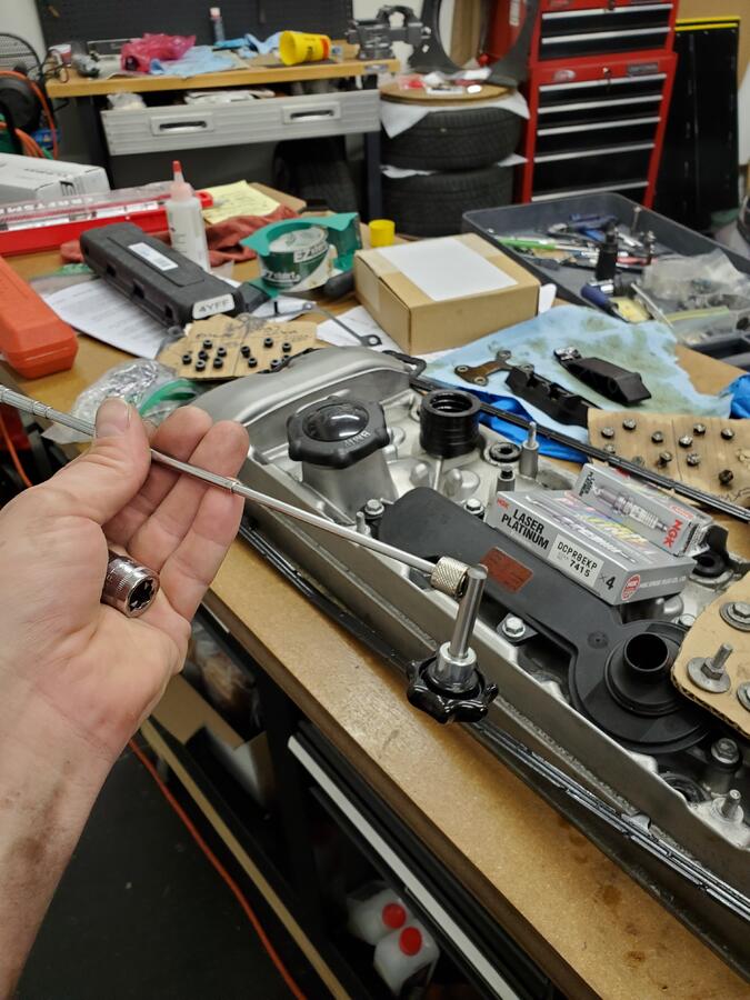

                  #38
ID:	77692 I hope the broken piece is able to do this and it isn't just picking up on other metals under the black area you grab.
                    #39
                    Excellent!!! You got it!
                      #40
                      umm no, think OP is showing that his magnet will pick up the broken piece as mentioned earlier some stainless is magnetic some isnt...
                        #41
                        Damn ... I was hoping it was success
                          #42
                          I feel invested in this...
                            #43
                            Maybe it's just the lighting, but I swear it looks like there's a broken piece of pin lodged in your other cam there?
                              #44
                              Made you look! Hahaha
                              Seriously...it does look like it is stuck in the cam.
                                #45
                                This would be an amazing discovery before tearing into oil pan. Nice eyes terra.
