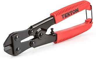

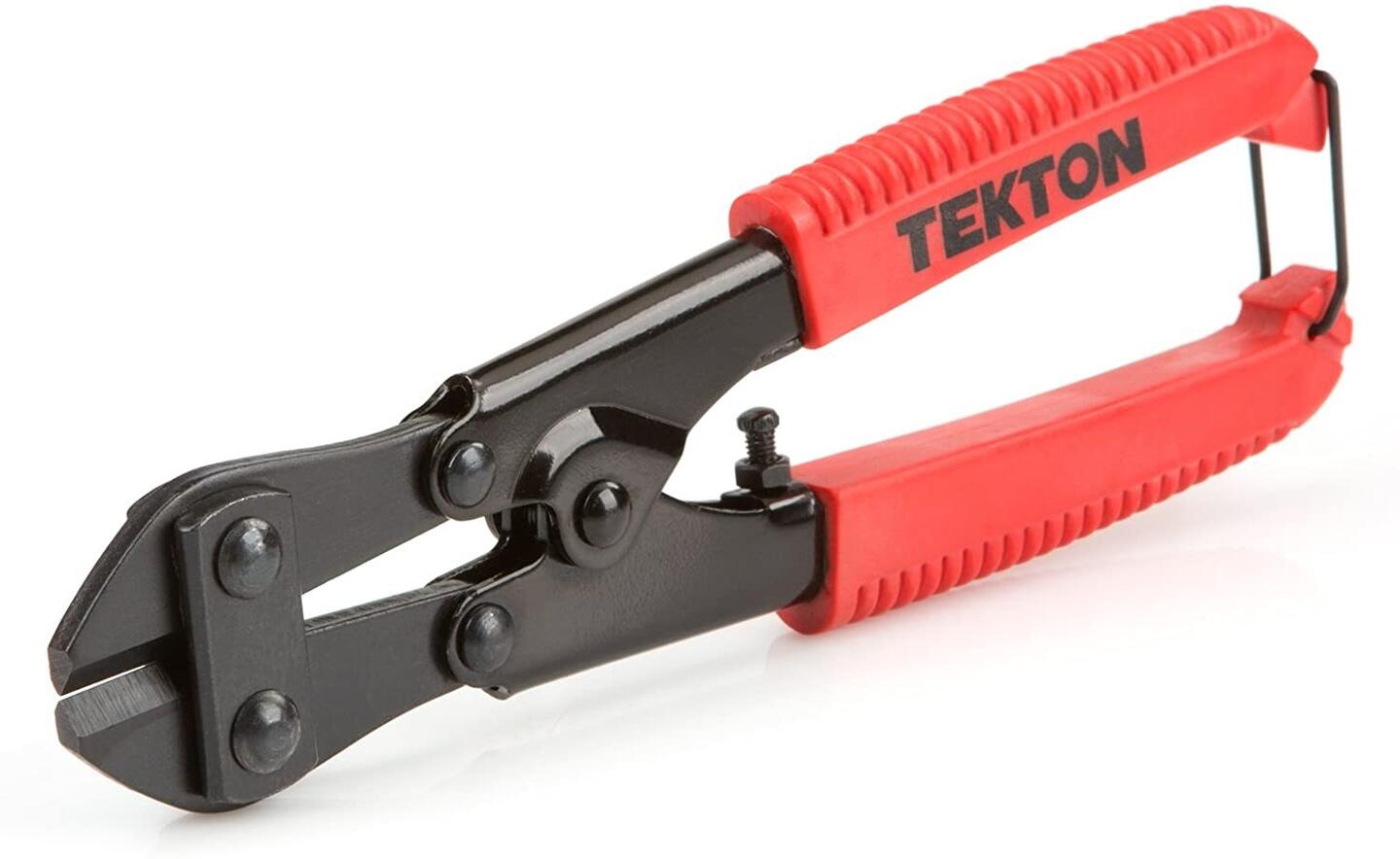

    I use these mini bolt cutters to cut off the Oetiker clamps.
    I've used them enough that I'll get in a Knipex one when these wear out.

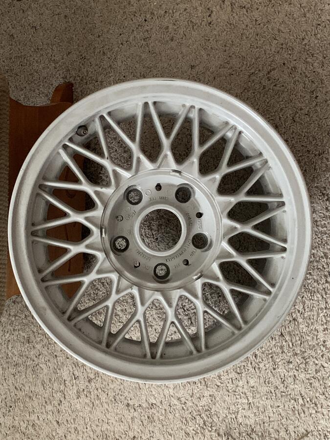

        Click image for larger version  Name:	C0F3FB0A-62E8-40AC-AB51-EF87A48670FD.jpeg Views:	0 Size:	130.3 KB ID:	78821 One of my special tools.
        I should edit to say that this E30 M3 wheel is my front wheel bearing puller

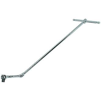

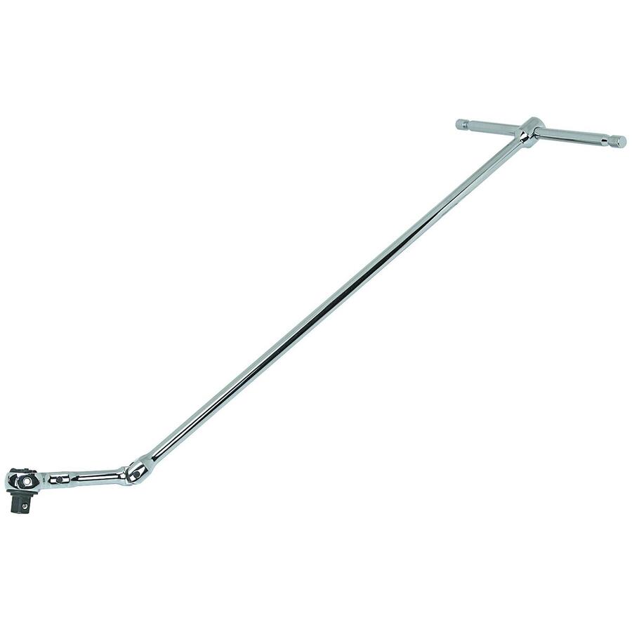

            ​​Please don't judge! But one of my favorites is a Harbor Freight product and it will NOT snap!
            I managed to removed my rear two diff bolts with this ratchet.

              This also is the magic tool for getting the starter bolts out as well!

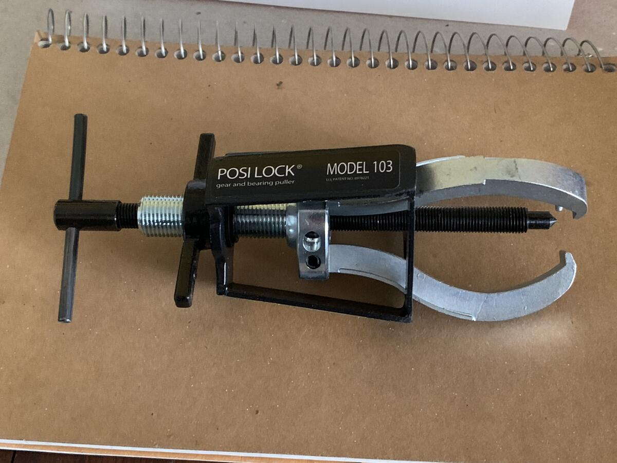

                I am hoping that this little puller will save me from having to dremel the inner front bearing race.
                For future front bearing Jobs. Click image for larger version  Name:	FD4C7F15-9406-494D-9800-BC497BC7C11F.jpeg Views:	0 Size:	115.6 KB ID:	85392From sears on line.

                  I heard that specific puller should help.
                  Did you try removing the front dust shield? It might give you better access.
                    #39
                    I'm also hoping that the jaws will slide in behind the race and not damage the dust shield.
                    I have a small pry bar that has a compact foot which will fit, but I have to dremel.
                    It would be a time saver if this tool does not warm the inner shield. (No biggie to replace, but another step/ part to buy.)

                      I used this one, while it's a bit flimsy, it worked really well:

                        That looks good. Compact hooks w/o the heel.
