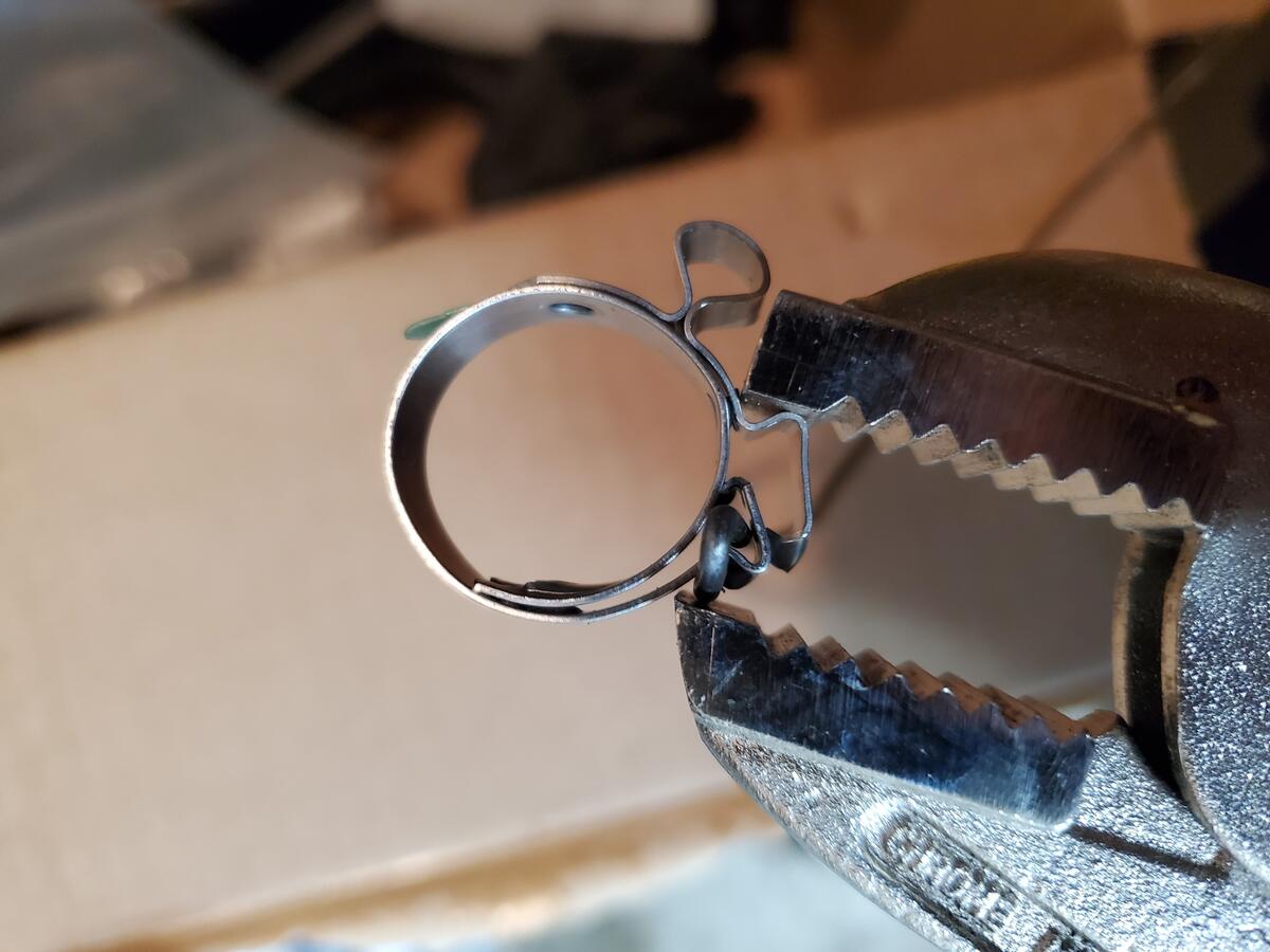

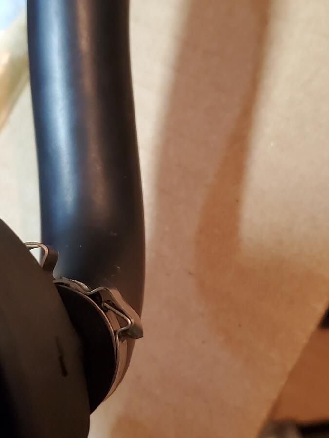

                      Just finished my power steering refresh and bought the BMW hose clamps, but didn't buy the tool to get them on. Managed to get them on with a pair of vice grips and an unbent wire hanger. Figured this might be a good place to share.
                      The clamps are tightened by slipping a tab over another, as shown in this pic:
                      Click image for larger version  Name:	20210110_181945.jpg Views:	0 Size:	29.1 KB ID:	78250
                      The problem is that if you use regular pliers, the top tab will be unable to slip over the flat edge (right side in the pic) of the bottom tab because the jaw of the pliers will be in the way.

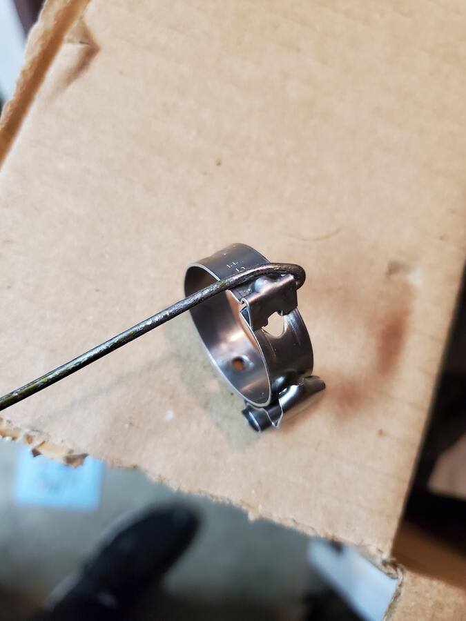

                      To get around this, I bent the end of the wire hanger 180° to make a little hook and put that into the bottom tab:
                      Click image for larger version  Name:	20210110_181606.jpg Views:	0 Size:	41.0 KB ID:	78251
                      Then I grip the whole thing with vice grips and set them to lock at about this point:
                      Click image for larger version  Name:	20210110_181903.jpg Views:	0 Size:	89.0 KB ID:	78252
                      After that, I just tightened the vice grips adjustment screw until I got the top tab to slip over the bottom one. The wire hanger leaves just enough space for the tabs to lock.
