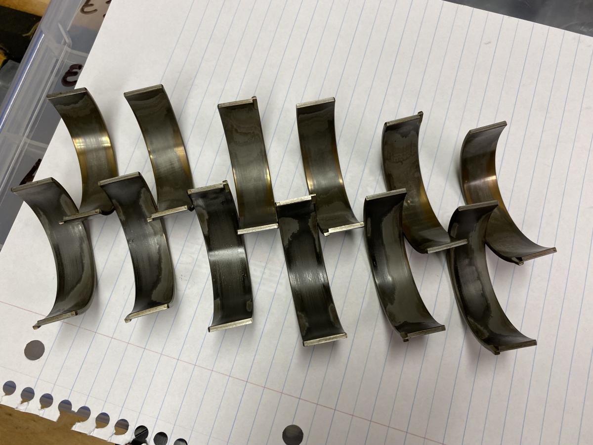

    Typical amount of wear at 125k, so those are most likely the original bearings for an 05.
    Leave a comment:
  • Notan_S54
    replied
    Looks very good for 125K miles. Are you sure these are original?
    I am not sure if these are the original or if they have been replaced. I do know however, the previous owner took VERY good care of this M3 before I purchased it in 2021. So I wouldn't be surprised if the rod bearings were done in their ownership. Car now has ACL coated bearings and ARP hardware so I'm happy I now have the peace of mind it's been done and that previous owner did their part to keep the car good too!
    Leave a comment:
  • sapote
    replied
    Originally posted by Notan_S54 View Post
    05 car with 125k miles!
    Daily and mountain spirited driving on the car.
    Leave a comment:
  • Notan_S54
    replied
    My contribution to the thread. 05 car with 125k miles!
    Leave a comment:
  • sapote
    replied
    Originally posted by BTB View Post
    This was from a few years back, but for the records … about 109k on engine. Engine is from an '06 model year and presumably had original bearings. I put the previous 55k miles on it including maybe 6 track days
    OH also under my ownership I drove this thing through cold Chicago winters, those super cold mornings didn’t help much I’m sure
    right side halves are the top?
    Not bad for 109K with some track days. This is good to have in the record.
    Leave a comment:
  • BTB
    replied

  • Go3go
    replied
    Good wear patterns; Could run another 30K miles.
    How often redline? Track? Hard acceleration?
    Good to know! I just got the car last year so I can’t speak to the previous owner’s driving habits. I’ve put about 6k miles on it but they’ve been pretty tame since the car needed quite a bit of preventative maintenance (vanos, cooling system, bunch of bushings, diff reseal etc). No track time, maybe a couple redline pulls a week (which will change now that I’ve got the car more sorted). Otherwise just freeway cruising to work at 3k.

  • sapote
    replied
    Originally posted by Go3go View Post
    Out of my 2003.5 6 speed, 75k miles. Cylinders 1-6 left to right, uppers on the top row. Not terrible but glad I went ahead and did them.
    Leave a comment:
  • Go3go
    replied
    Leave a comment:
