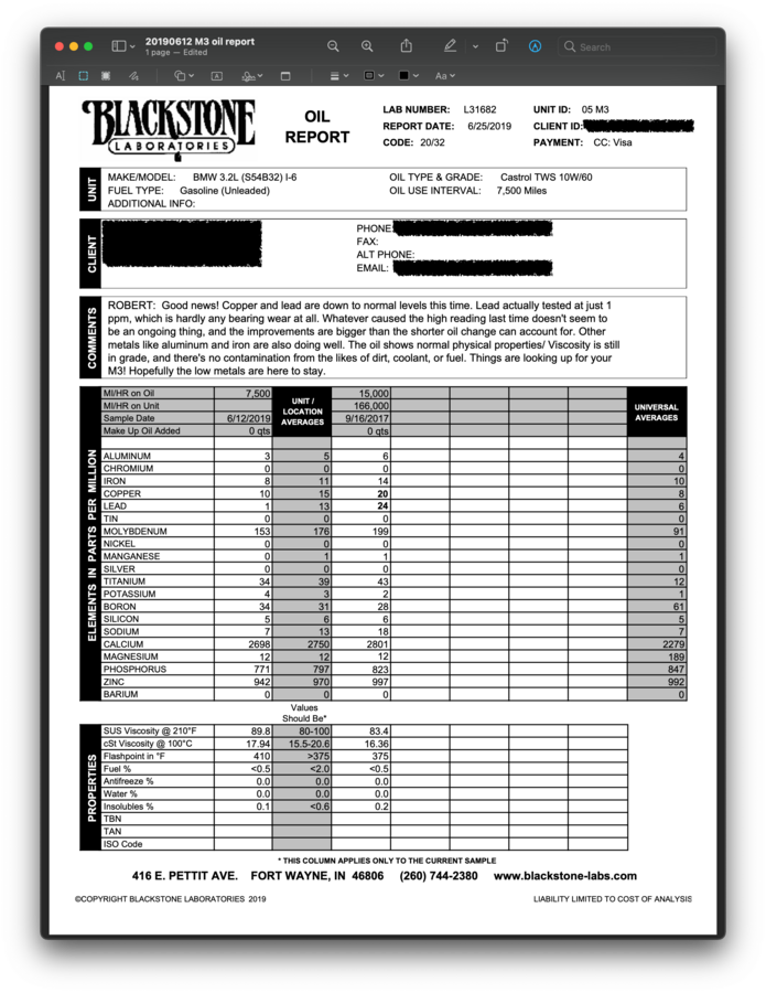

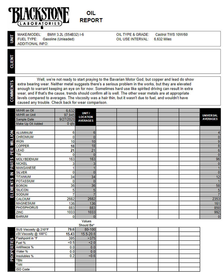

    2004 with 95k miles. Tracked on r compounds, not sure it makes a difference.
    Looks like we are doing this again at 151k miles 🤬
    I will update once I get my report back from Blackstone, but last one was showing copper high at 16 ppm while lead was at 2 ppm. Might do BE and ARP this time instead of BMW bearings (these are WPC treated)
    Car runs fine, no noises or anything weird ... just did an oil change and found this:

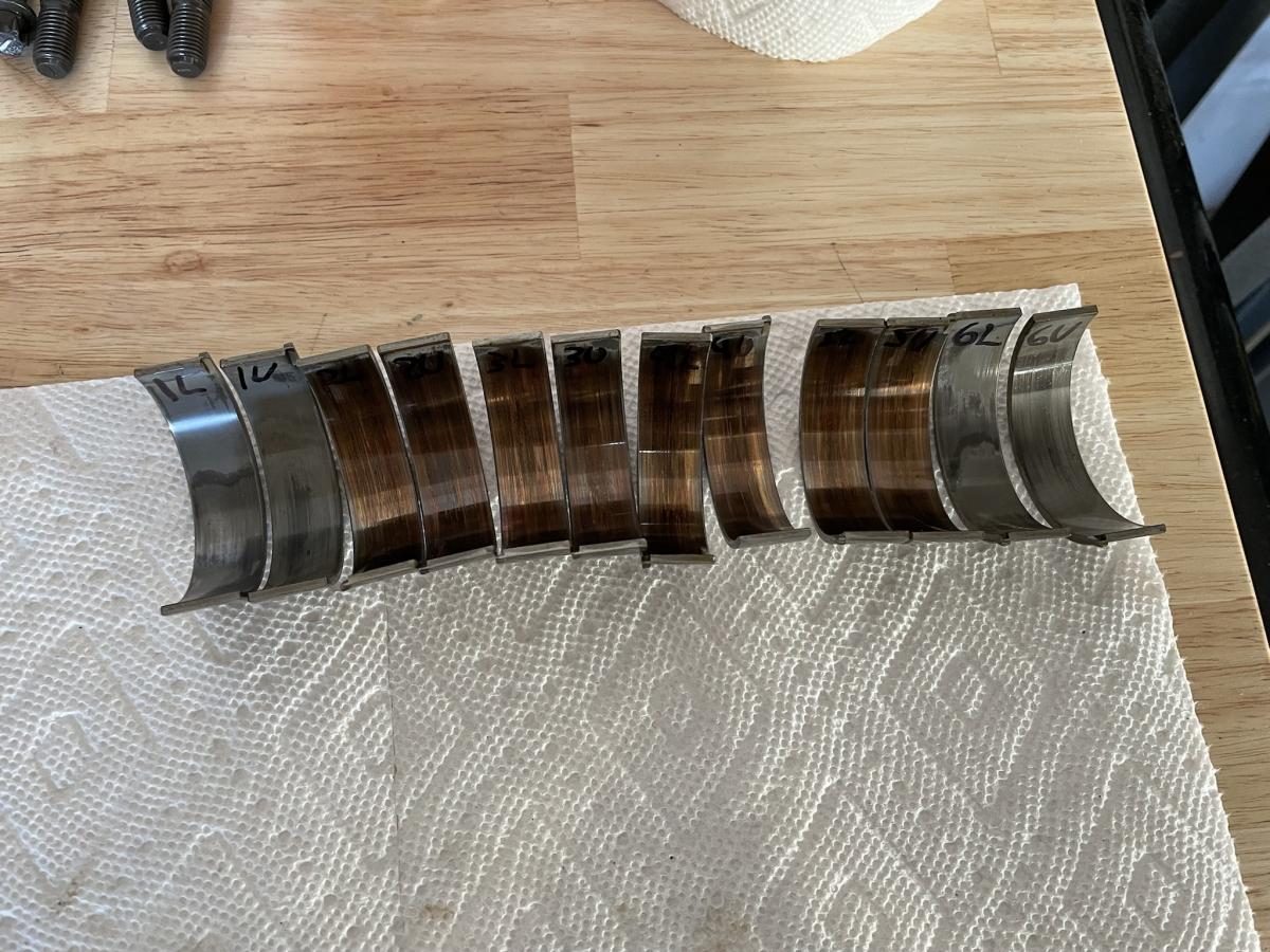

    Originally posted by tlow98 View Post
    just to follow up here. The dealer network was searched. There is no evidence that these rod bearings were ever done by the dealer. And fwiw, the pics don’t really show how worn they were. There was copper of some sort on every top and bottom. The tops showed guide a bit, but never did the copper cross all the way across the bearing like you see in spun bearings or bearings that are about to spin.
    Ok, here we go.
    211k miles. 2002 SMG convertible. I’m doing a full engine rebuild and just dropped the block, heads, pistons, and crank off at the machine shop. The piston and cylinder wear are well within spec so intend to re-ring, hone and go. The main bearings looked nearly new save for #7 that has slight wear.
    I have decent maintenance history and all
    major jobs were done at the dealer and show on the carfax. For non major jobs I also have Midas receipts for oil changes and a drain plug that was stripped and replaced at some point. So, yeah it was treated ok, but never looked after with an open checkbook.
    I believe these to be original. Not bad I thought?
    Every rod bearing, save for two, does show some sort of copper, however.
    https://imgur.com/a/KjjGweU

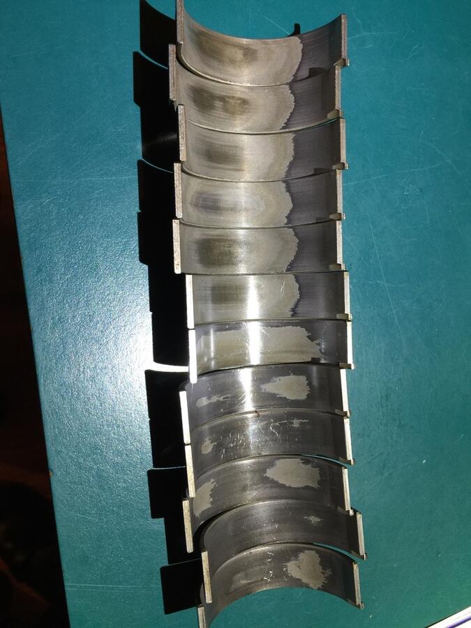

    2006 M3, 100.7 k Miles.
    Blackstone reports showed clean health (3 consecutive submissions, last one being about 2,000 miles ago)
    Overall looked pretty good except for cylinder 4 and 5?
    Click image for larger version  Name:	IMG_0941.jpg Views:	0 Size:	153.9 KB ID:	181777
    Ok, here we go.
    I'm assuming those were replaced at the dealer at some point because of the 02 model year. Any idea when that was done? They look pretty good regardless.

    Ok, here we go.
