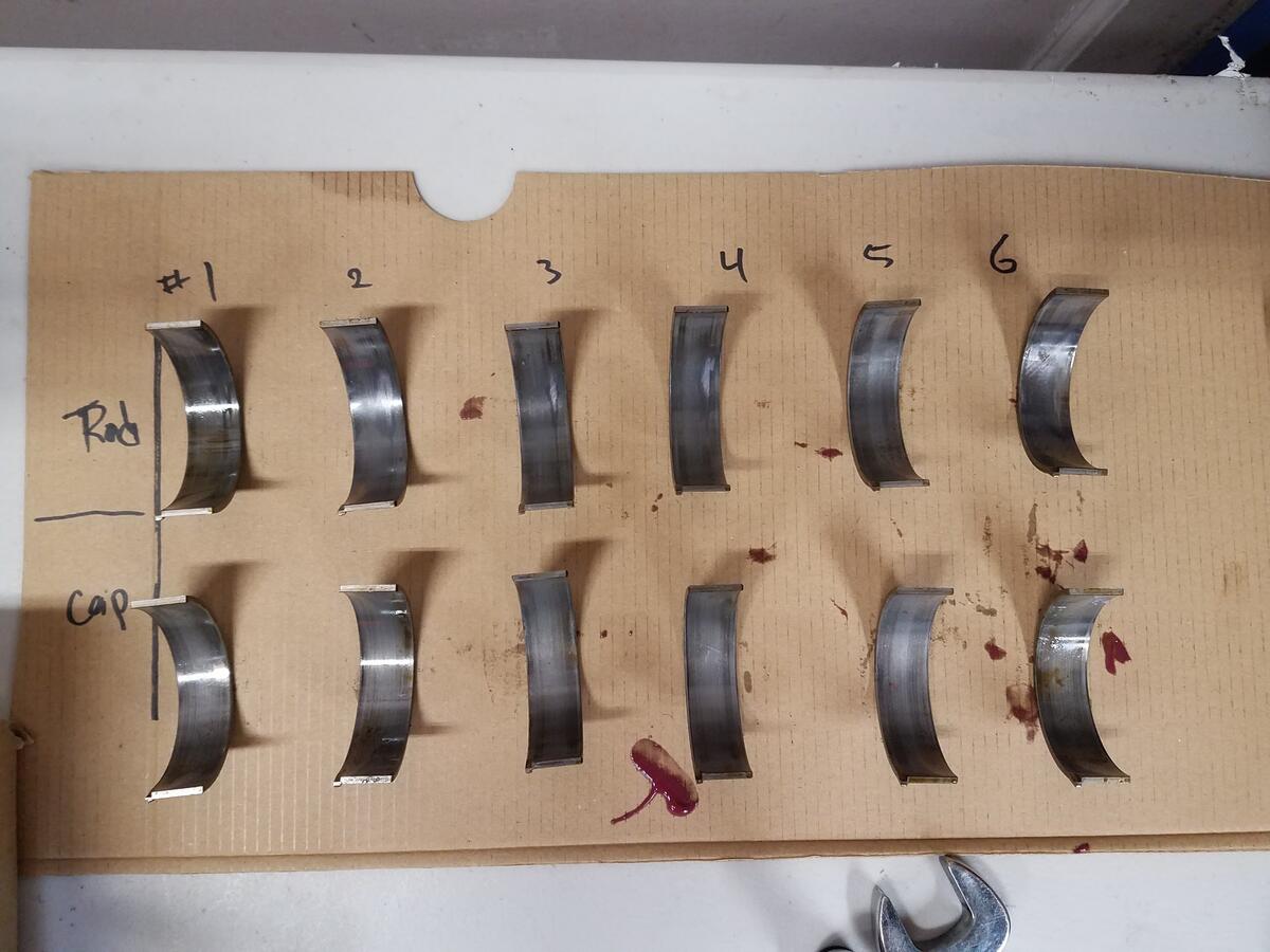

    1, 2, 3 tops
    4, 5, 6 tops
    All the bottoms looked new

  • Nate047
    replied
    108K miles and 2001 MY. Bearing still looks good, and so depending on driving style, the bearings condition might be for 108K miles, or less if the dealer had replaced them. Call up the dealer and ask for bearing renew history.

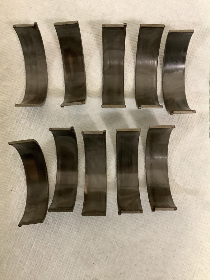

    replied
    51402432488_c49261ef3d_k by Nate Hassler, on Flickr
    Mystery bearings with mystery miles. Car has 108k total. No idea when these were done, and with what bearings. What do you guys think?
    Glad to have the job done, one less thing to worry about. Had VANOS done as well. Big 3 officially complete.

  • Nate047
    replied
    They have kind of a weird wear pattern, but I don't see any copper so they aint too bad?
    Yea I mean I'm far from an expert, they don't look bad but I'm glad I did them still for peace of mind.
