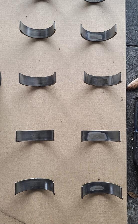

  • DJAM3
    replied
    07/2001 production with 112k miles. Bought the car with 48k miles. No record of previous rod bearing service.
    Click image for larger version  Name:	51397255714_ae6cdac6f9_b.jpg Views:	77 Size:	160.3 KB ID:	122521
    Last edited by DJAM3; 08-26-2021, 10:28 AM. Reason: Edit: Forgot to add that I've been running Motul 5W-40 in the winter, 10W-60 in the summer.

  • sapote
    replied
    2003.5 with 102k miles. Not 100% sure if they were changed before but I'm leaning toward no.
    Excellent condition. I wish mine look like those when I remove them. Currently it has around 70K miles if I remember.
    Leave a comment:
  • Sid_E46
    replied
