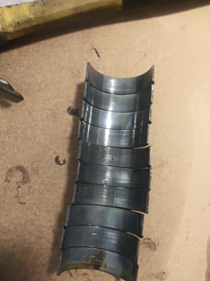

    2003 M3 production date 10/02' w/ 110k (had the bearing recall done prior by previous owner at some point mileage unknown best guess was about 50-60k). I've been doing only track only miles, only a track queen.

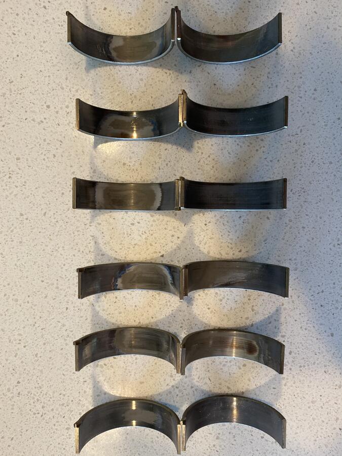

    These came out of my first S54 that spun a bearing. 180kish on them, always proper warm up and then redline every chance I get. Spun one not shown. Kinda messed up that all these could look so good and one still decided to spin. If I really want to stretch my imagination the new bmw turbo oil was in it at the time, with how good these bearings look, maybe that shell stuff wasn’t up to the task. Ran castrol up until the last couple of oil changes. Like I said a stretch and we will never know, but I probably won’t be using the shell stuff again. Ran it on the new motor that blew up too but that was a unique circumstance.
