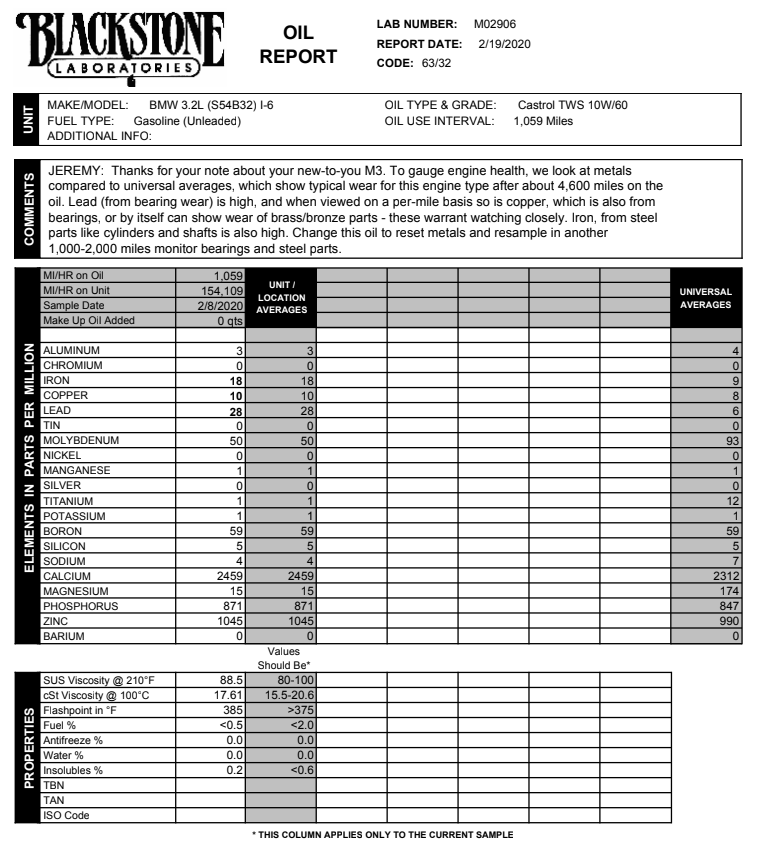

    Had the rod bearing recall done around 25k and then these done at 145k. Mostly highway miles, but still, they were ready to change out. Glad i did it now and didnt wait any longer. Blackstone wasnt showing much copper

    Bearings changed at 97,658 based on the trend in lead in multiple reports.
    Click image for larger version  Name:	reportbeforebearings.jpg Views:	0 Size:	130.2 KB ID:	92827

    My rod bearings at 80K . . .
    Replaced with OE, WPC & OEM bolts
ID:	72343Click image for larger version
Name:	Screen Shot 2020-12-08 at 9.44.18 PM.png
    Oil Change 1200 miles after rod bearing job . . . Blackstone analysis
    Leave a comment:

    198K, 2004, no copper showing but the "spring" was gone in several suggesting detonation pounded them at some point. Not bad at all and probably could have gone another 60k.

    2006 M3 62K sure looks like it was time, no thanks to Blackstone it has been done.
    blackstone62k.pdf
    Click image for larger version  Name:	m3top.jpeg Views:	0 Size:	64.2 KB ID:	71072

    changed them in fabruary. 120k miles. oil analysis was good. so i won't do an oil analysis again. btw thats km on the analysis. just changing the oil a lot and will change them when I feel I need to.

    2006, first time replacement at 91k miles. Blackstone was showing relatively high levels of copper all the time, but I didn't like the increase of all three lead, copper and iron in the last report. OCI ~7500 miles, didn't do Blackstone every time. Planned to do it around 100k miles, but used the downtime working from home and not needing to drive to get it done.

    #2 was the worst. Not sure the blackstone matches the bearings?
    Definitely glad I got this done and didn’t delay.
    Those are surprisingly low numbers on the report for a 13k mile oil interval and the look of the shells...
    Have you tried sending your pics of the shells back to Blackstone to get their take on "everything looks great".
