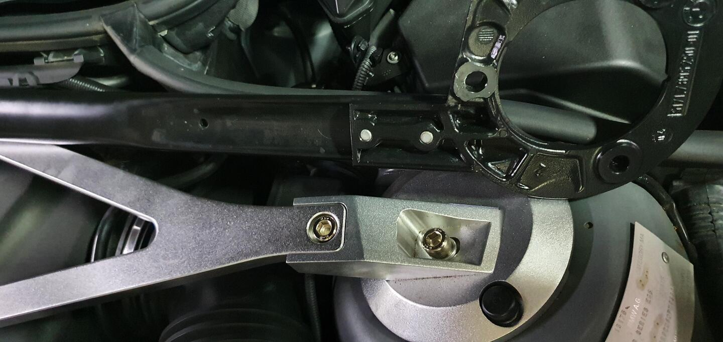

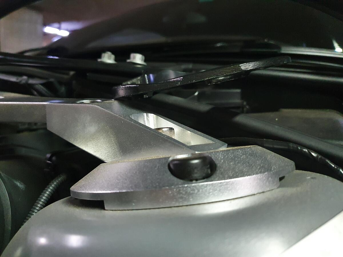

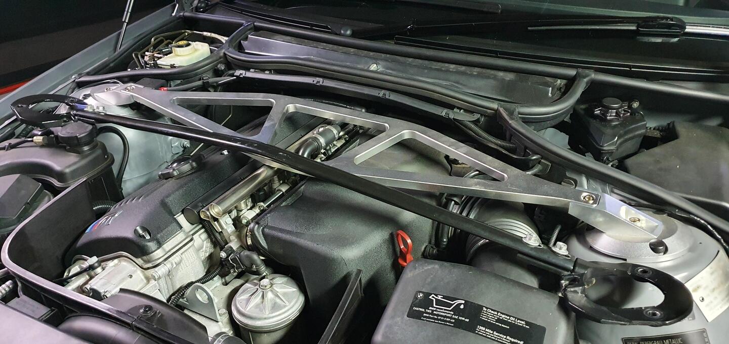

    I assume you have not properly examined the original strut bar - nor have you driven my vehicle 🤠
      Originally posted by Toby22 View Post
      Riiight
      • For a strut brace to be effective it needs to be strong enough to stop/reduce very small movements
      • A 'vert's chassis moves more than a coupe as it does not have a solid roof as a structural element - Ipso Facto, a vert may well benefit from structural reinforcement elsewhere
      • If you put a bend in a metal structure it becomes a weak point
      • A solid piece of metal is stronger than the same section made out of sheet metal
      • A square section metal extrusion is stronger than a round section - which is again stronger than an oval cross-section (when the forces are perpendicular to the weakest point of an oval cross-section)
      • Last - but not least, the BMW design with moveable bolt slots in the bar itself means that it was never seriously designed to carry any structural load (In the aftermarket setup the adjustment slots are on the turret - which are at an angle and therefore the whole stucture is locked together).
      • As the side-by side comparison pictures below between the original brace and aftermarket illustrate, the stock brace is an oval cross-section made out of sheet metal with a bend in the middle. The turret mounts are also unsubstantial in comparison - it appears to be a flimsy piece of shyte in every way when compared to my aftermarket solid cast CNC'd aluminium brace with no bends in sight - and my driving experience after replacing it confirms that to me
      As I said - once removed the BMW strut bar can be flexed at the bend with your bare hands. It's structurally useless.
