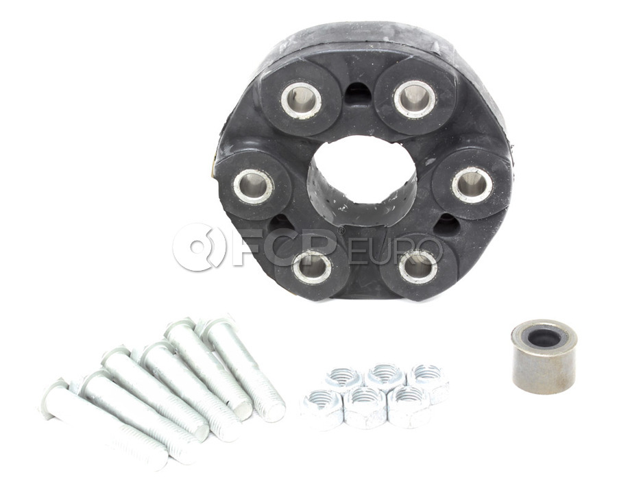

              Here's a more simple answer.
              When your car is on a lift, look underneath where the transmission mounts and the driveshaft is. If yours has cracks or chunks missing then its time to replace it. This is what a normal guibo looks like.

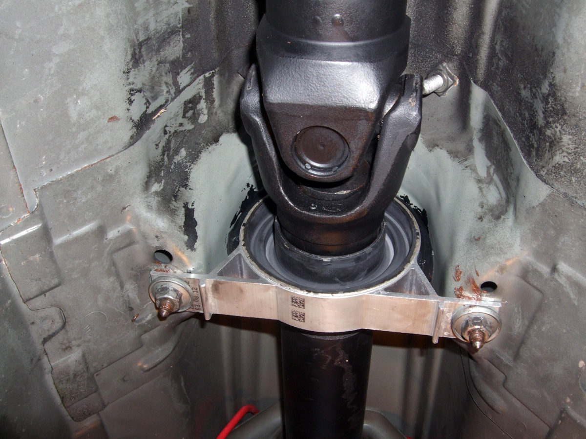

                You should also check the center support bearing which is not far from where the guibo is. If you replace your guibo you'll want to replace this as well.
