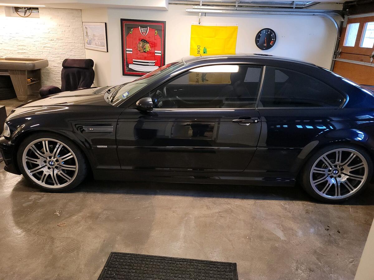

    Click image for larger version  Name:	568771D3-D77F-4A24-A18A-CCFB517DE2AD.jpeg Views:	0 Size:	157.4 KB ID:	84046So I got my dream car from high school - 2003.5 m3 carbon black 6 speed with just under 21k miles.
    Was owned the first 15 years or so by an Exonn engineer who did all of the tasteful upgrades and servicing - I assume he did a lot himself. He drove the car a lot the first few years relatively speaking (around 15k miles first 4 years) and then went overseas for exonn and put the car in storage.
    The car was then purchased by a collector who had it for 3 years and put less than 1,000 miles on it, but spent 5k paint correcting and doing a full PPF.
    here are the mods.

    they checked the subframe and it didn’t have any cracks.
    question for you guys....vanos should be addressed with this low of mileage? Rod bearings replaced at factory so good to go there.
    best to just buy a refurb vanos and get it installed from my Indy shop?
    anything I am missing?
