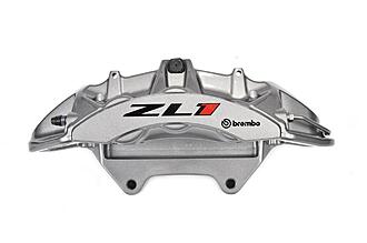

                    With 380x34 and 380x28 balance is fully the same (66.8%), as on stock With 325mm front
                    I'm having difficulty getting to the stated 66.8% front bias. Granted, I don't have the exact specs for this group buy but I found commonly-used Brembo caliper GT piston sizes. While there are many more Brembo GT rear sizes (and thus piston combinations), with the large rear rotor, the rear caliper has to be towards the smaller end of Brembo 4 piston offerings. There seem to be significantly less piston deviation for the Brembo 6 piston calipers, with most either (in mm) 42/34/32 or 38/30/28
                    My closest result was:
                    Front disk: 380mm
                    Front pad width: 57.5mm
                    Front piston sizes: 38/30/28 mm
                    Rear disk: 380mm
                    Rear pad width: 51.3mm
                    Rear piston sizes: 30/26 mm
                    Front bias result: 66.07%
                    Not trying to be difficult but rather, seriously considering this kit and would like to be an informed buyer.

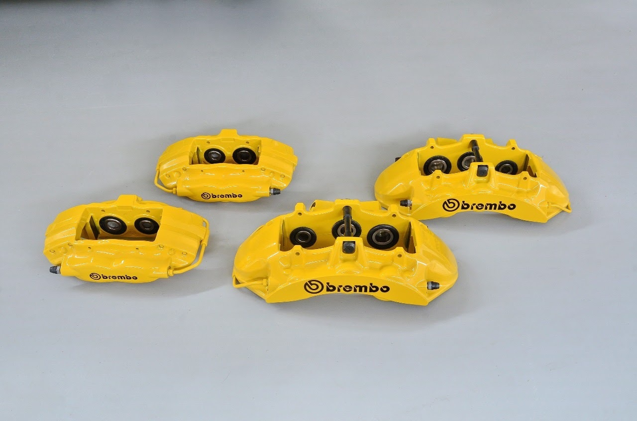

                      I don't mean to dominate this thread. I am excited by this unique offering and appreciate Epoustouflant coming into this forum to make it available.
                      My thinking has evolved more in the meantime:
                      1) IF - and that's a big if - I got those piston sizes right, 66% is on the money with stated 66.8%. Its not that OP isn't trusted, but its nice to verify. So how to verify without detailed piston specs?
                      2) I zoomed in on the pic of the 4 yellow calipers on in EDIT: its actually in the google docs, page 3 - also pasted below. It shows the inside of a front and rear calipers. Put a ruler up to the computer screen and note the measurements for each of the 5 pistons. Plug them into the bias calculator (doesn't matter what your absolute measurements are, just how they are relevant to one another). I got a result of 65% front. Again, right on the money of where we want to be.
                      I also discovered a blog post describing and showing how these BBK's are assembled. The calipers get repainted after machining (I was wondering how they offered the M-blue color). See here:
                      https://slon-workshop.ru/2018/03/27/...slon_workshop/
                      Given all of that, I joined the group buy. Looking forward to seeing how it goes. Please don't kick me out, OP!

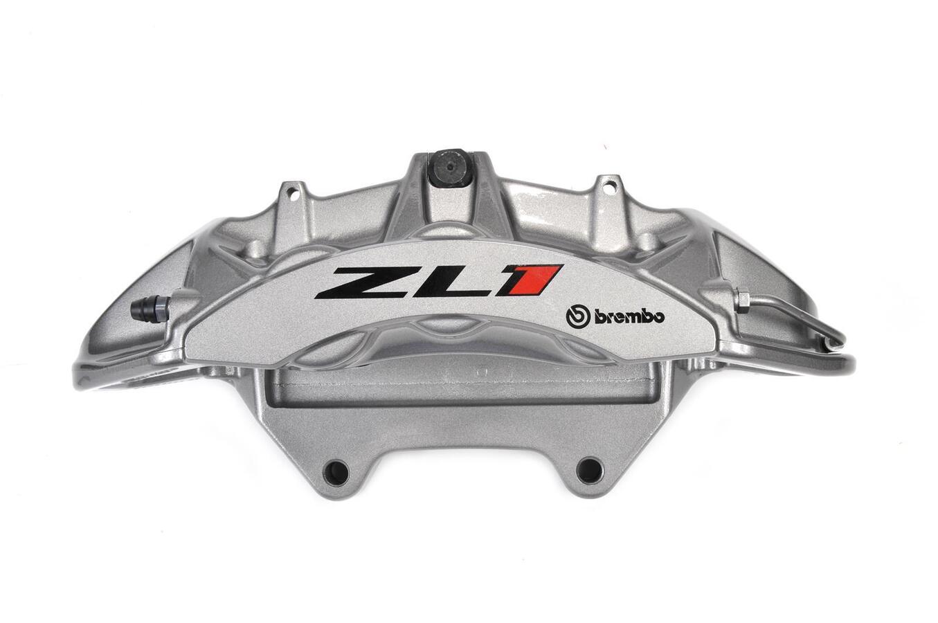

                          Yeah good info, thanks for working to track this down. The blog post is interesting, says they are using GM calipers. After some digging looks like it is these (or similar):
                          Click image for larger version  Name:	ado-172-2826_jv_xl.jpg Views:	0 Size:	71.0 KB ID:	84648
                          And wow they are cheap on Summit!! Less than $500 a caliper. Rebuild kits also pretty cheap. Clever solution by Slon.

                            No worries about the questions - it’s refreshing to answer critical & technical questions!
                            Here are the piston sizes. You were close.
                            - 30/34/38 front
                            - 28/30 rear
                            The calipers are sourced from the C7 Z06 (front) and ZR1 CCB (rear). They are machined for bracket mounts, readily available from Brembo and have an immense pad along with an extensive selection.
                            Glad to have you aboard. You’re the first E46 👌
