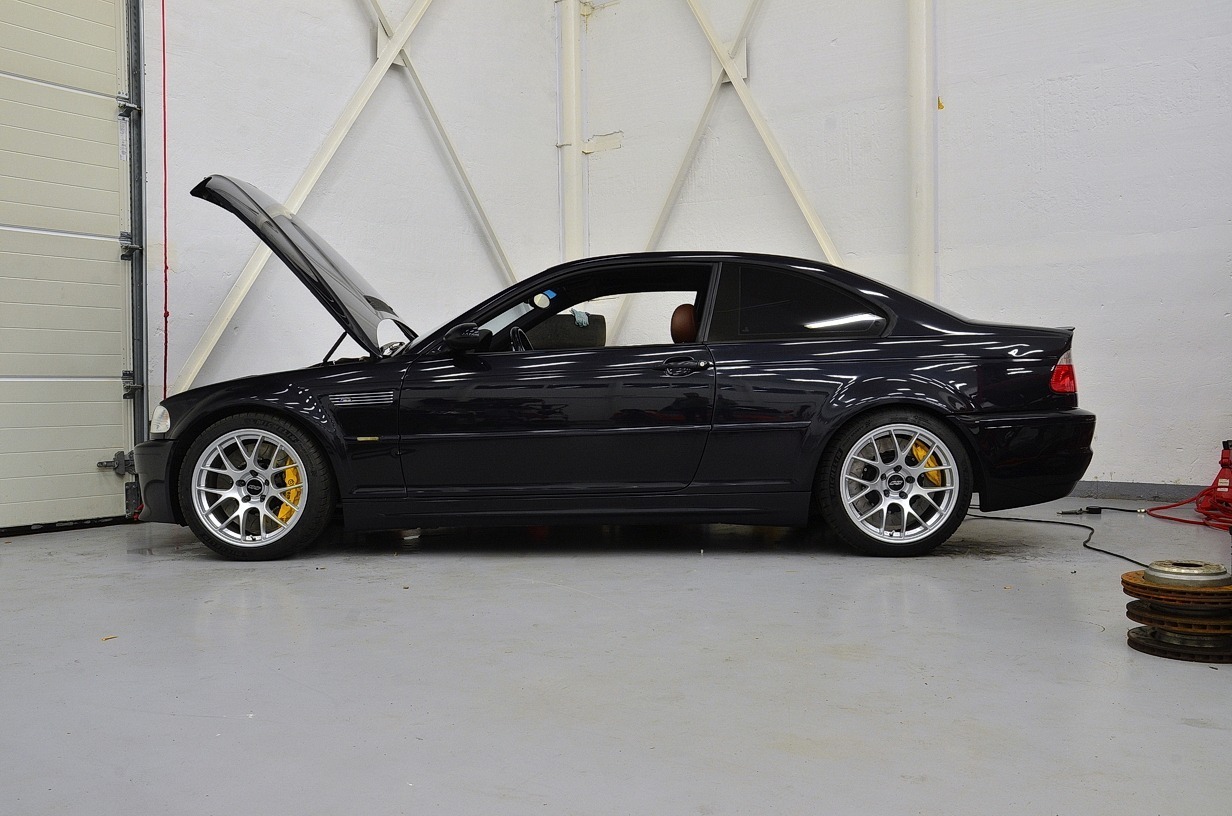

    With the Slon-modified 6 piston Brembo caliper w/ 380mm rotors, you wonder if it gives you more or less wheel clearance for 18's. As compared to the E46 M3 Brembo kit. I personally run 19's but there are some that shy away from Brembo 380mm kits because of inability to run 18's (in addition to other reasons).
    The pic in post #1 (and pasted below) shows Apex EC-7s in 18" size and the only wheel specs that clear are an 18x9.5" ET35 with an added spacer. At least according to Apex's site:
    That's a pretty sporty front wheel fitment. You cannot tell from the size if that's being used on this particular vehicle. Maybe the OP knows more about 18" clearance with this kit?

      Rule of thumb in E9X world is if F8X calipers template clear an 18”’ spoke profile, this does.
      Apex’ EC7 were designed for this, whereas the ARC8 do not clear.

        - Wouldn't you know it, I've gotten interested in an 18" wheel set and starting talking with Apex. I think their EC-7R (forged) looks killer. Espoustouflant's comment above was helpful. Here is some additional commentary from Apex after I laid out the components (including BBK) I was working around:
        Thank you for reaching out in regards to your E46 M3. For the 18x9" ET30 front and 18x10" ET25 EC-7R wheels, we have tested those specs to clear the F8X steel brakes without any issues. Therefore, those particular wheels should work just fine to clear your aftermarket BBK. Fitment-wise, when using 245/40-18 front and 275/35-18 rear tires, this setup should be a complete direct fit on your E46 M3. Even with KW V2 coilovers, no spacers will be required with the 18x9" ET30 up front.
        The reason this is significant is that the 380mm Brembo kit for the E46 M3 does NOT clear an 18x9" ET 30 Apex front wheel as I alluded to previously. So this kit offers more versality than the factory Brembo kit.
