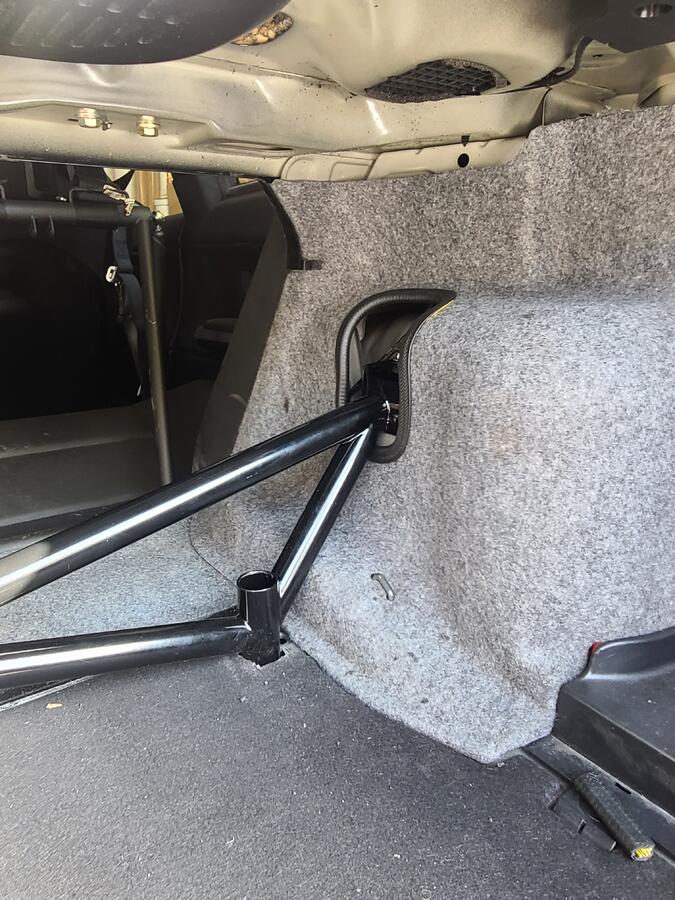

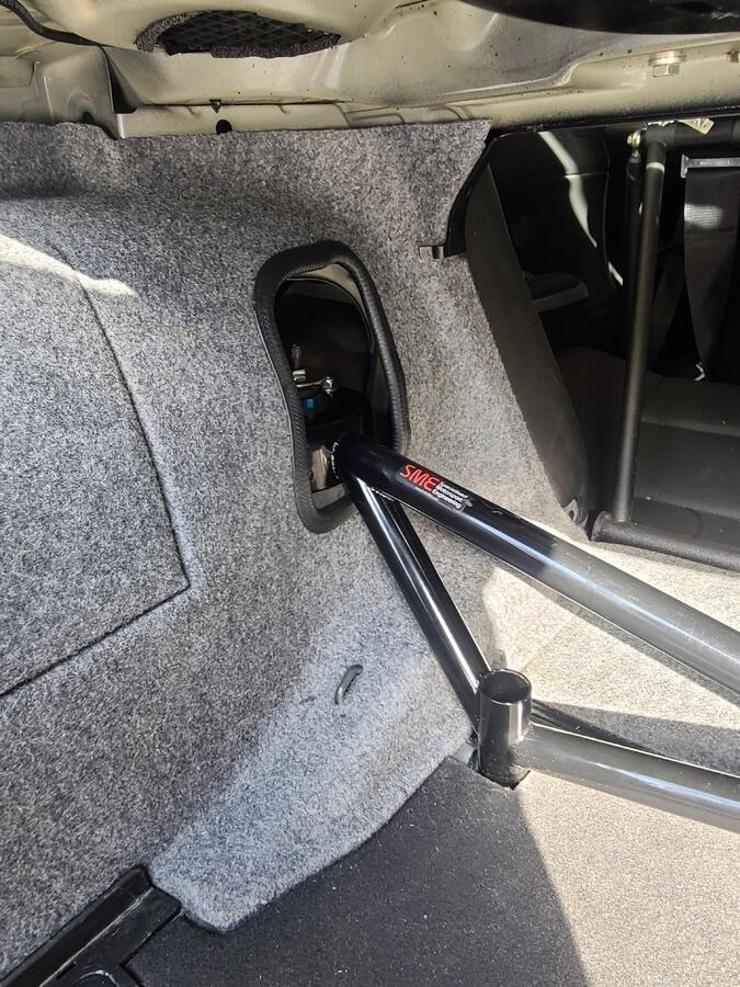

        not gonna take credit as i saw a few other people do this. cleaned up the edges by the shock mount. love the way it came out. improves the look of the holes.

                Wow that looks really good. Here is what mine looks like with the PureTech bar...

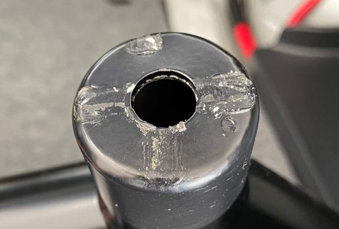

                  Did you guys have to flatten out the upside down T with the bumps so the bottom of the x-brace would sit flat?

                    depends on which x-brace you installed. each have their own approach to the installation. in my case, i spoke to SME and their braces, as they are all 1-piece solid, say you should NOT flatten the T-bump as it's designed within height of the shock mount and the T-bump. i don't know what the other vendors suggest in their instruction.

                      The PureTech is a solid X bar but bolts to each rear strut tower. So there is enough play with how it bolts in that you could flatten out the T-bump, but I did not do this.
