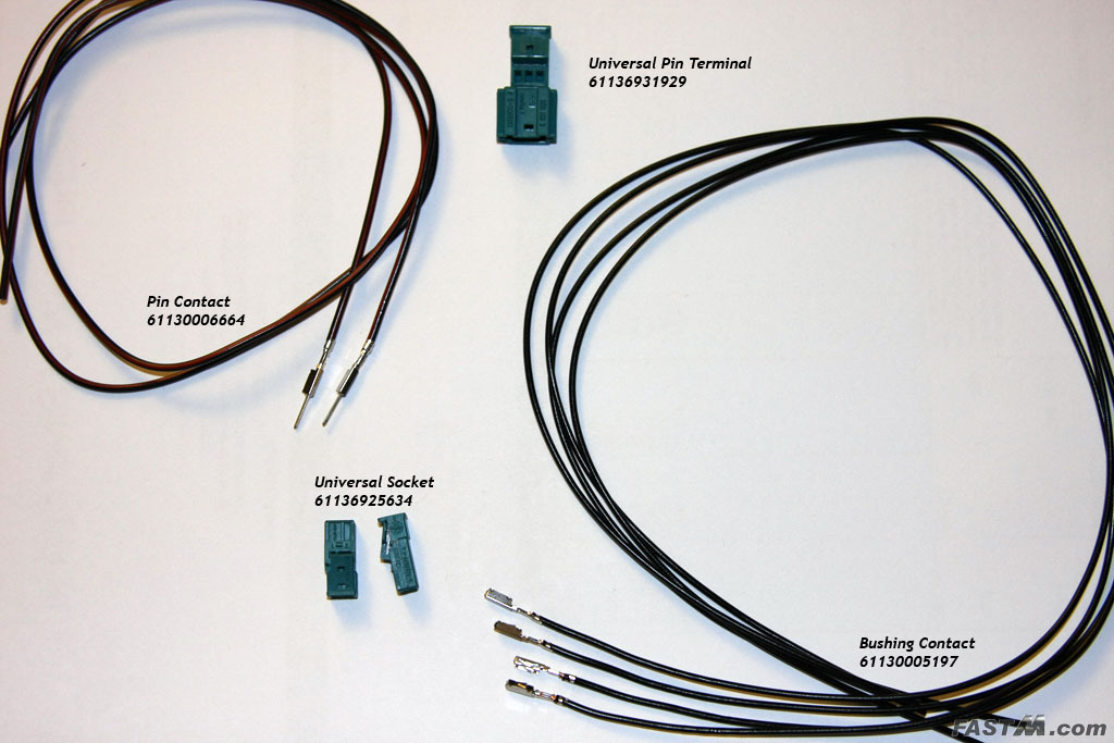

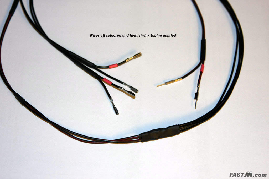

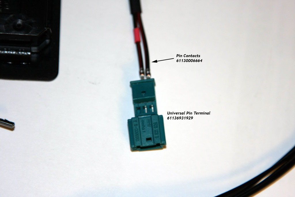

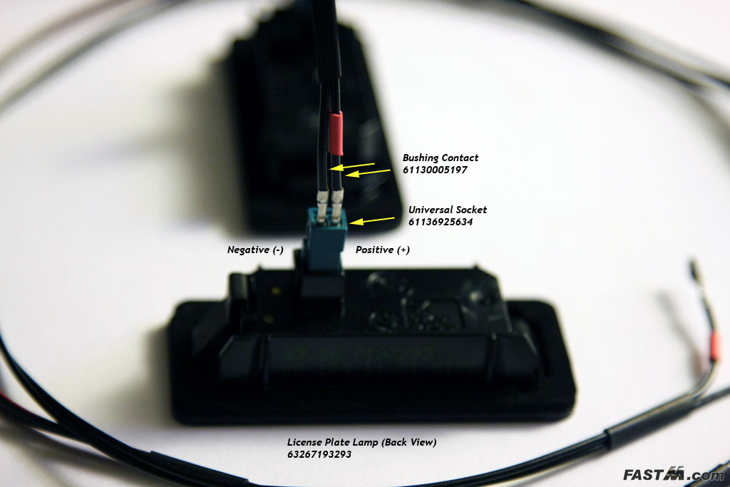

                            Uploading some old stuff I pulled from M3F for future reference.
