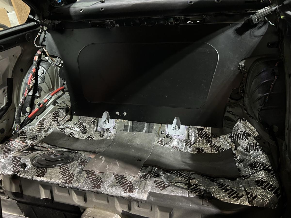

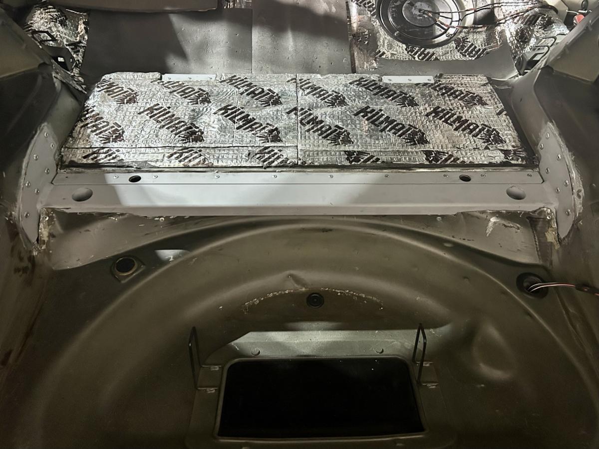

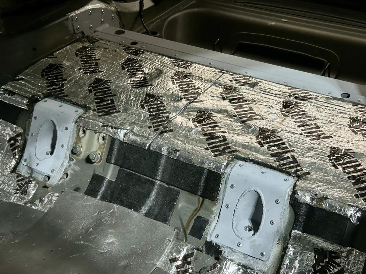

          I just installed the epoxy version of the Vince Bar. It's important to watch his four part video series - including Part 4 from July 2023 where he clarifies details on the stud and bolt kit.
          Part 4: https://youtu.be/Lx9alL9a718

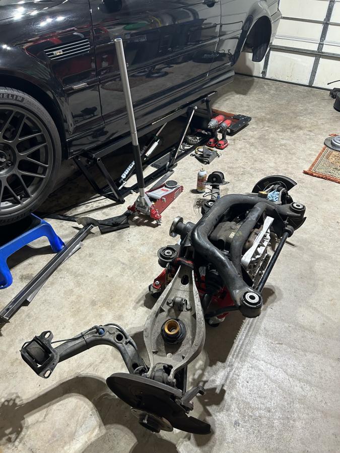

          From my lessons learned, the previously mentioned "DIY: VinceBar & Redish Motorsport Upper and Lower Subframe Reinforcement" thread is excellent - huge props. I have one suggestion if you use that DIY as a primary source: look at Vince's videos carefully to determine how much metal to remove for the rear bar. The pictures shown in the DIY appear to have about 1-2cm more material cut out than what Vince does per his videos. Use the OEM bolt holes as the reference. This is an important connection to make.
          It's hard work, dirty, and you'll need all the tools recommended in the DIY. Add a transmission jack or similar and it makes handling the entire subframe with differential still installed doable.
            FWIW when your all done with installation use a bendy magnet to recover all the metal shavings small and large you can get, I was surprised at just how much I retrieved.
