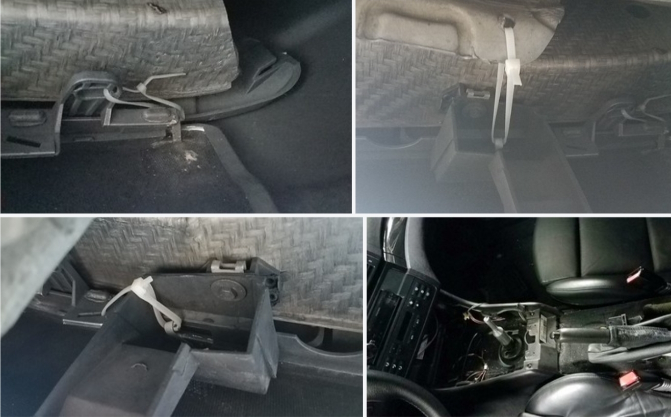

                  I went thru your build thread and could not find the info on diffuser installation;
                  Mind sharing some tips & details here?
                  I had mine installed last Fall and although the finish looks great for what I paid (~$400 painted), the installation and final fitment was subpar; I did bend the metal tabs after inserting them into their designated slots; Perhaps I didn't pull & bend them in tight enough?
                    Unfortunately, it was all lost on m3f, but I was able to save these pics ^
                    I rolled the metal tangs into hook, then used zip ties to pull the diffuser into the bumper and body in various places.
                      Ah got cha. So it most likely requires zipties to really lock it down in there.
                      Thank you for the tip! Will get this done when the weather gets warmer.
                        Ya the tangs by themselves were pretty useless in my experience.
