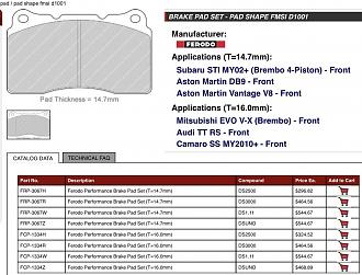

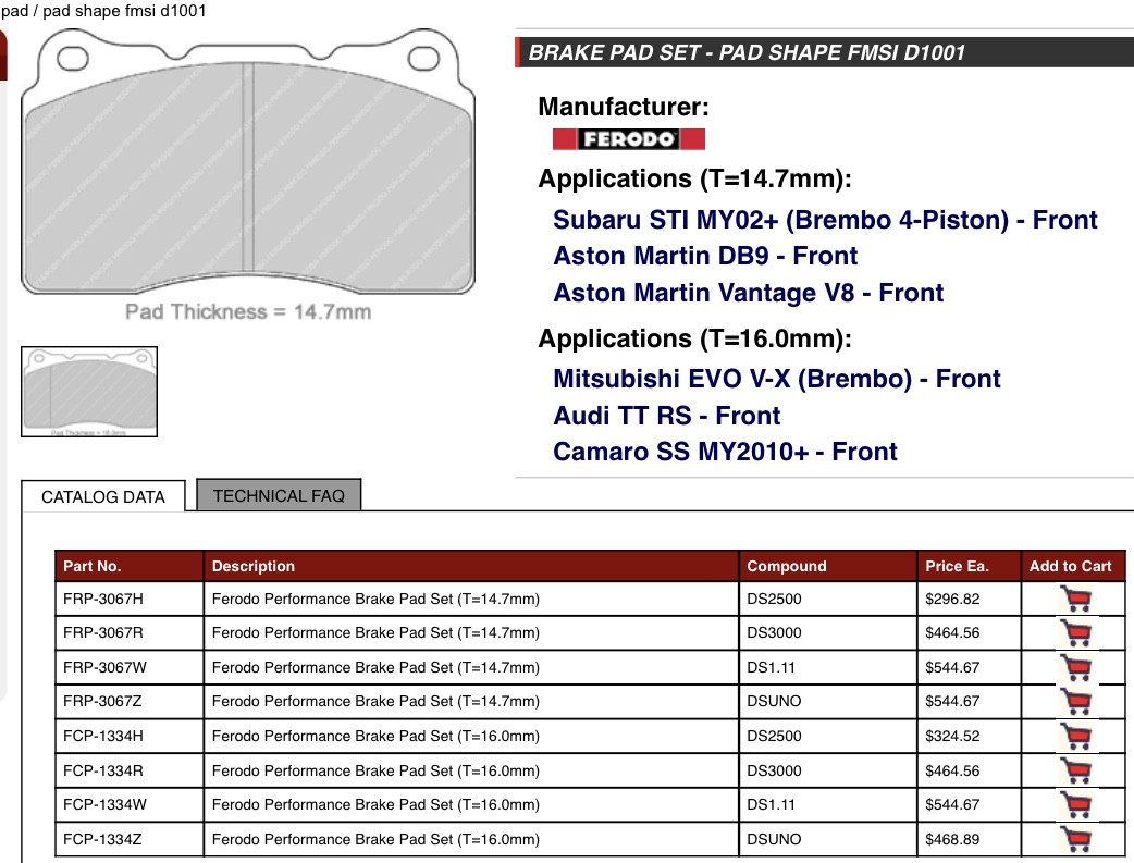

            Nice, I’ve been following this thread as I’m planning to do the FreakyParts 345mm kit with Girodiscs as a track day upgrade (paired w 996 rears). Curious, what D1001 pads thickness did you use? Seems some brake pad manufacturers offer different thickness of the D1001, either 14.7mm or 16mm. I plan to run the 16mm (also seems more common option, from the 8J TTRS, Camaro SS and EVO X, while the thinner 14.7 is for the STi and hard to search for Astons) but want to make sure there wont be any fitment issues with the Girodisc 345mm rotors.
            Here’s Ferodo’s info on their pad thickness offerings:

                I'm running 16mm GiroDisc GP10 street pads, and they fit in there. The calipers seem set up to swallow up to a 30mm thick ring, so the 28mm factory-sized ring leaves another 1mm of wiggle room on top of that.
                Some manufacturers make different versions, some just sell the same 15mm pad for all those applications.
