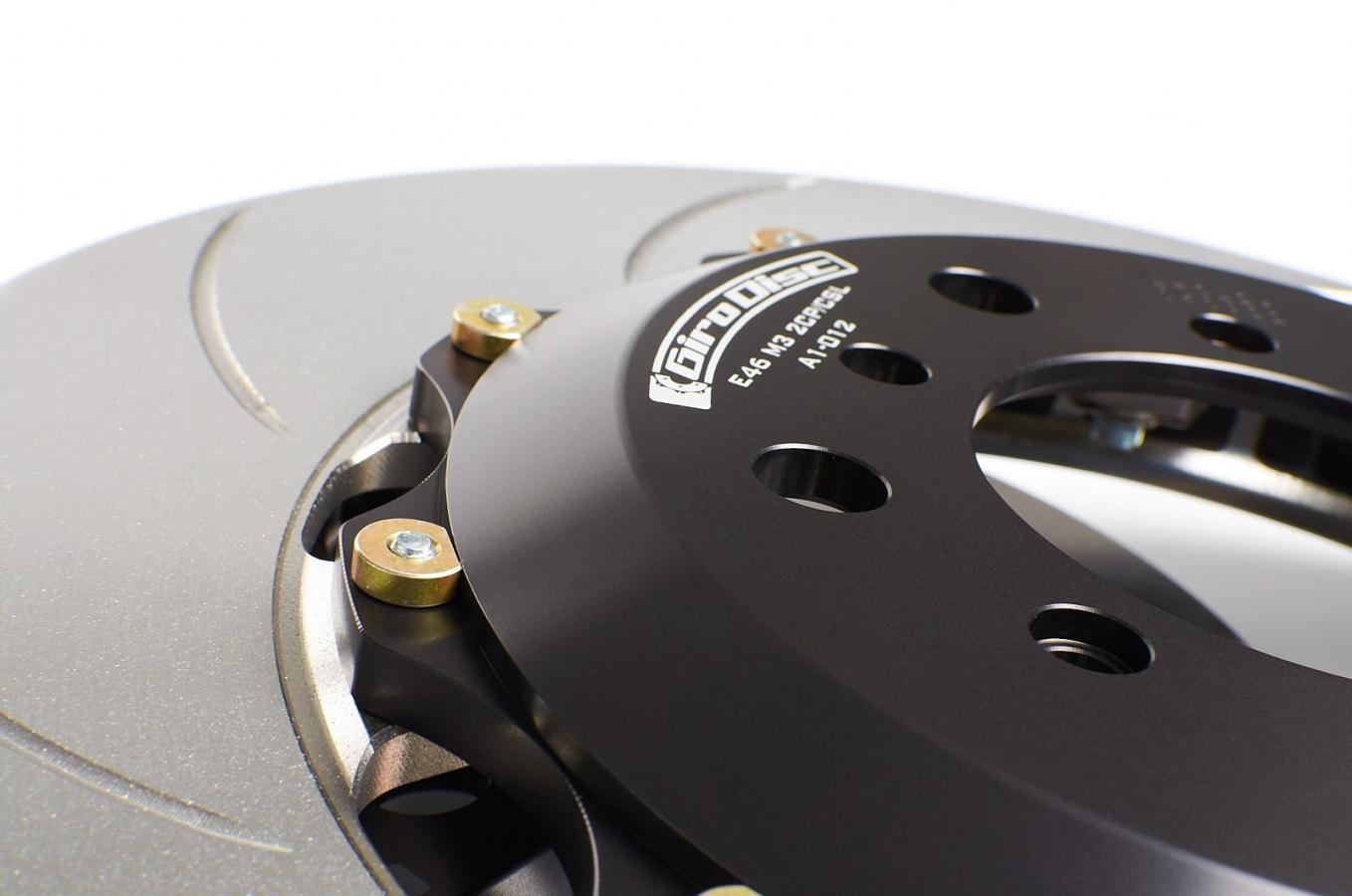

          Teaser pic, Bimmerworld listing coming soon.

            Looks sick. Any idea the weight difference between these and stock or ZCP rotors?
            These came in at 17.5 lbs per assembly (hat + ring with hardware). I have in my notes that the ZCP co-cast rotor weighed 19 lbs when we had a new one here. Can't recall if it was a genuine or Zimmermann unit, I can double check if we documented that.

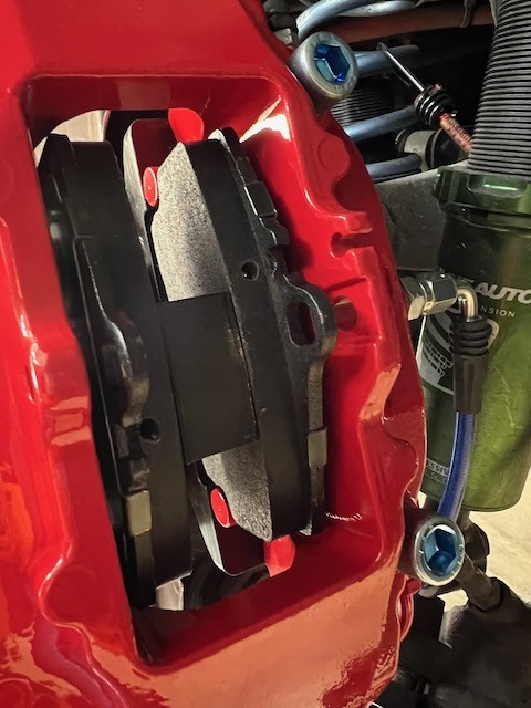

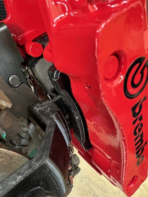

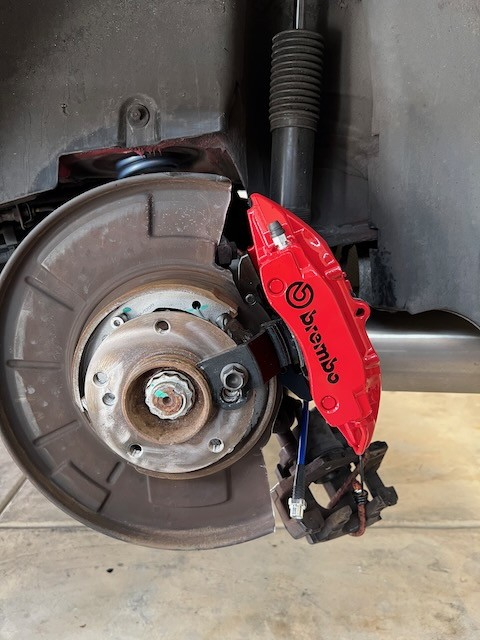

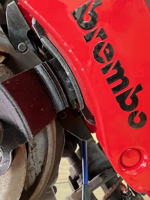

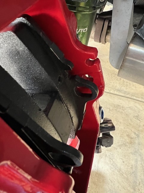

                          We made some progress today. Thanks to rapid prototyping via 3D printing, I test fit a proof of concept cross-section to see how much room there would be with a Porsche caliper. Plenty of clearance. Note that this is with the D738 pad shape (much more common Cayman rear) versus the D737 shape (986 front) which people run to sweep the full E46 rear rotor.
                          For the fellas who want to keep the stock rear caliper, I double checked with PFC's current stock on their 7855 shape. This is the custom shorter pad they developed to run with their own 2-piece rear rotor. They have plenty available in race (including PFC11) and street Z-rated compounds.
                          With this setup, we should be able to run off the shelf pad shapes while retaining the factory e-brake.

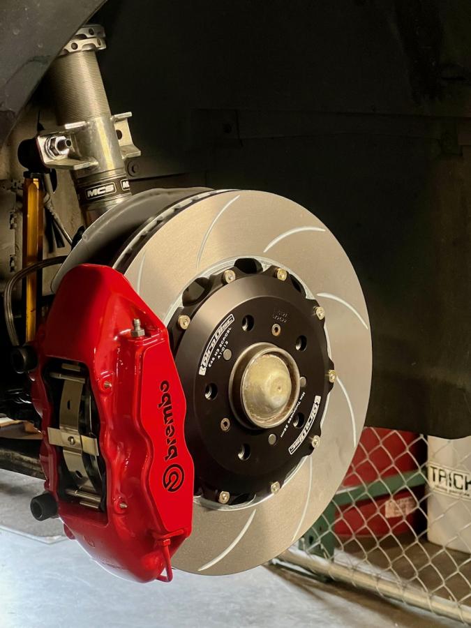

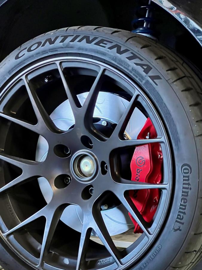

                              Finally had the chance to install my front Megane RS kit with the rotors and they fit like a glove. I'm still impressed by the bang for buck with the Freakyparts kit. Rears are next on my list!

                                NIce, can you share your impressions when compared to stock? I have 6-Pot E82 calipers and they are nice, but if I am honest they dont have as much bite. the calculator shows they have less clamping than OE, and it shows. I think these with the larger pots dont degrade clamping force. do you know the piston size?
