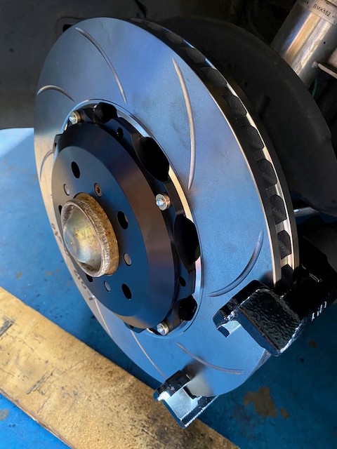

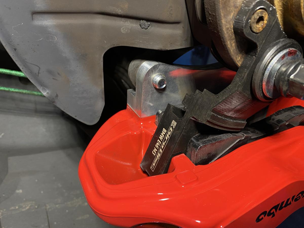

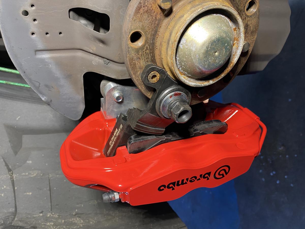

        Good timing, I finally have some news. We 3D-printed a cross-section of the rotor assembly as we had it designed. I test fit it on my car with two setups: stock caliper with ZCP/CSL bracket (special thanks to Bimmerworld for lending us one) and my Freakyparts Brembo caliper setup. I've attached some photos if anyone is curious.
        We did this test-fit with these setups for a few reasons. First, there was an unknown variable in terms of where the caliper spring clip sat relative to the hardware on our hat. We best-guessed it, but wanted to see it on the car before we made anything out of metal. Second, the D1001 pad shape in the Megane caliper is one of the tallest pads out of the setups that people run with ZCP rotors. If the pad material + backing plate clear the hat with an acceptable amount of clearance with this setup, we're confident that the other options (Porsche calipers, specifically) will have no issue as well.
        Everything checked out, and the prototype assemblies are being manufactured. The hats will be heading to our anodizer this week and I should have a pair of rotors to share with you guys in 2-3 weeks' time. I appreciate everyone's patience on this, but it seems like we are finally getting somewhere. I've had this brake kit sitting in my garage since Black Friday of 2020, so I'm happy to be installing it.

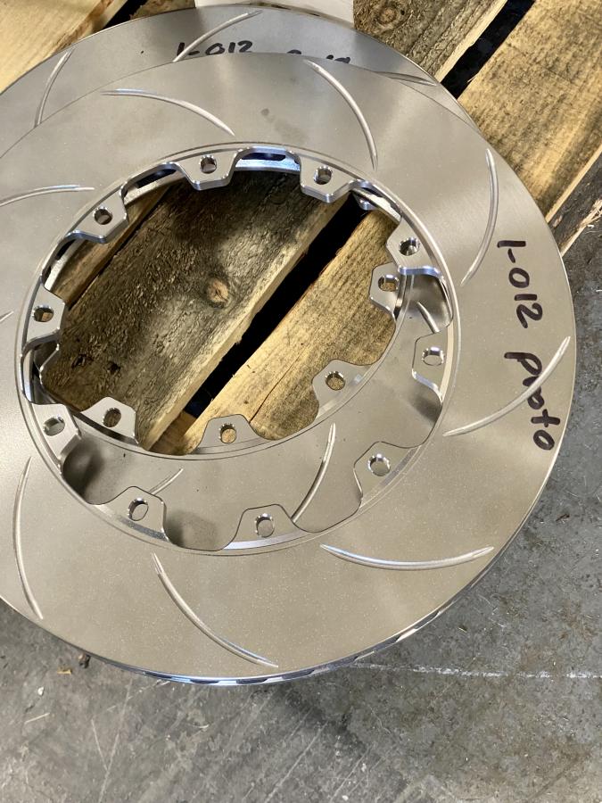

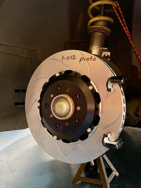

                            Some teaser pics, fits great. I'm going to take the official product photos tomorrow and put the initial production orders in.
                            Note that the hardware is not correct for assembly, this was just to bolt them together for the test fit.
