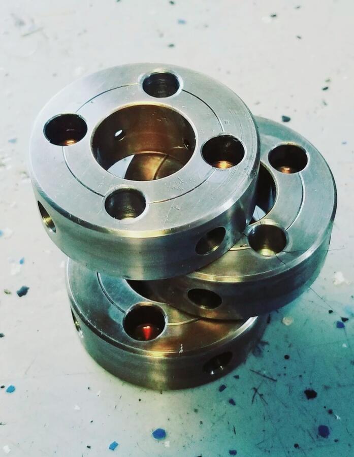

  • sapote
    replied
    This one from the internet shows the cleaned circle almost miss the the pistons holes and so it restricted the oil flow into and out of the pistons. The cause: too much clearance between the roller inner race and the circular locking ring, allowing the escaped oil on the front side of the disc (driver vu) to push the disc rearward until stopped by the lock ring/washer. It needs to be shimmed forward. What were the factory boys doing?
    Edited: As we can see the wear marks by the hub tabs on the disc holes, and so the disc moved rearward until it touched the tabs, not the washer/C-clip as I first thought. I optimized the disc position and maximize the oil flow, 2 proper thickness washer added between the disc holes and the tabs.

  • sapote
    replied
    Yep, that’s the cleaned circle and it seems a little offset below the piston holes.
    Leave a comment:
  • Cubieman
    replied
    Everyone, when you have a chance to have the used disc on your hand, look carefully in the disc center hole and you should see a "cleaned bright" circular line by the 115 bar oil jet: Is the circle cut the 4 small piston hole at their centers or off set from the centers? I believe a perfect installation should have the circular line cuts the 4 holes dead centers.
    Does this photo illustrate the "cleaned bright line"? I know it is hard to see, this is a photo I found online. Will inspect mine in due time.

  • sapote
    replied
