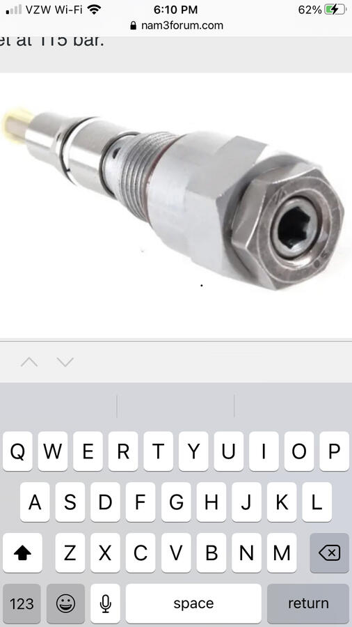

          According to a source, the new revised valve is this one with 115 bar set: 11367838080.
            It always kinda surprises me that 20 years later, there aren't straight answers for these kinds of things. It feels crazy to me that none of the guys who designed and specced these engines are the type of car guys to want to talk about these things with enthusiasts and put knowledge out there for them?
            I've thought about that a lot too. Imagine how much speculation could be avoided if just one of the engineers who worked on the S54 was on here.
              Negative, that is the part number I bought back in September 2020 from www.getbmwparts.com
                Does your new valve’s locking nut made out of solid metal as this one:
                  Just like that, as opposed to the thin tin nut on the original part.
