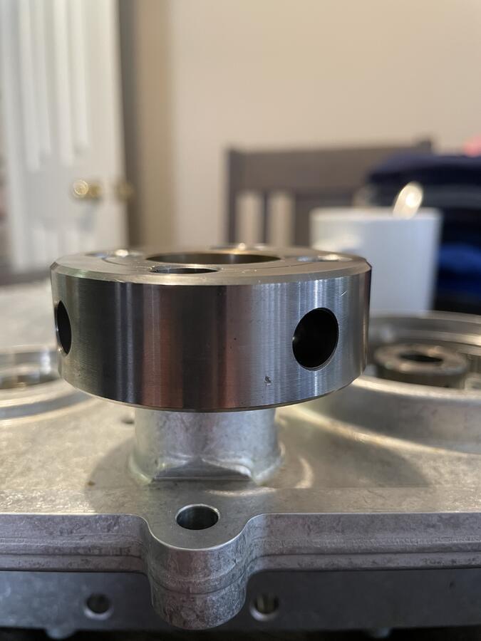

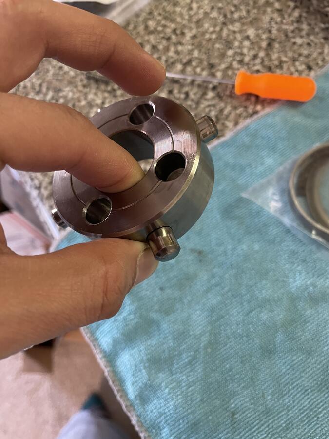

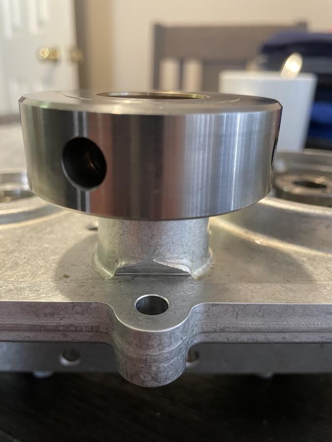

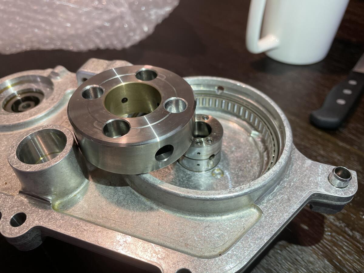

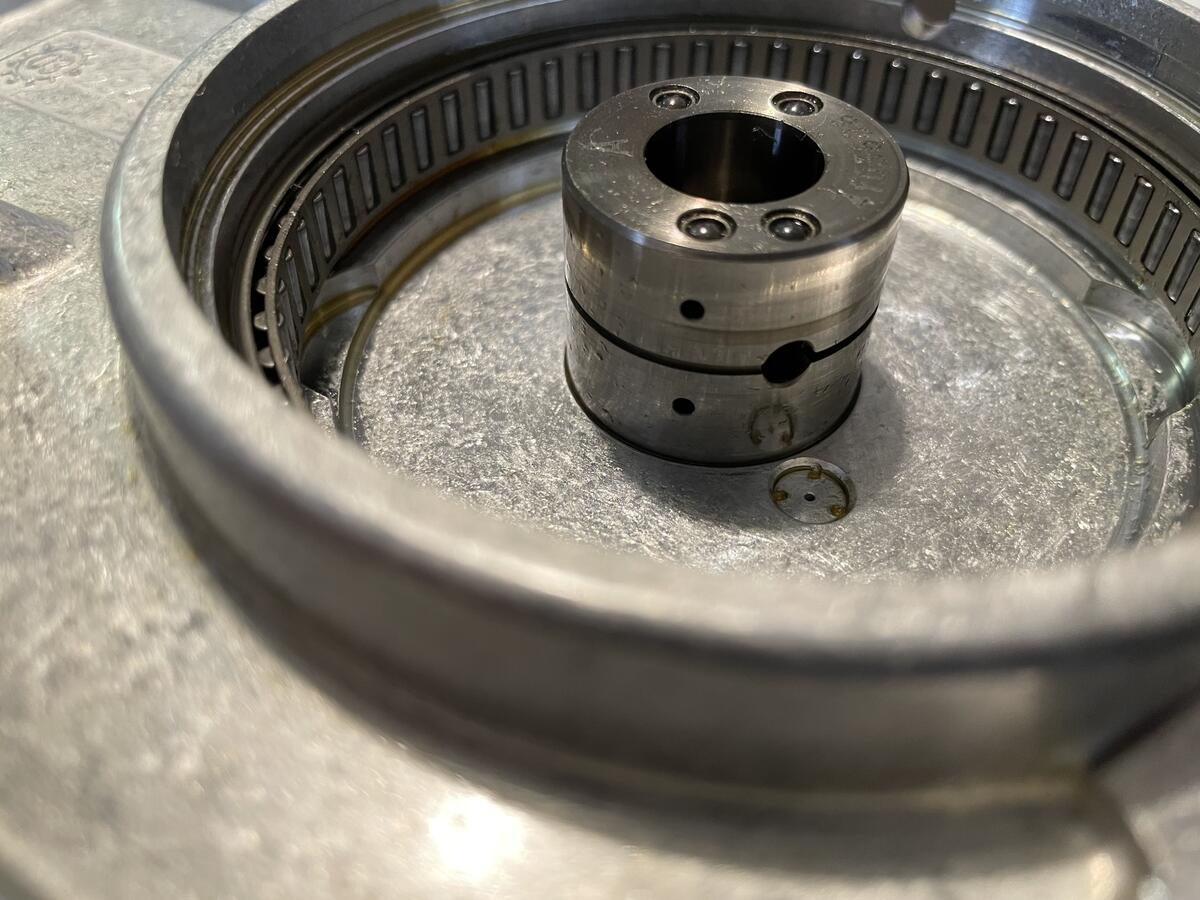

    So i have become fascinated by how this thing works and love the tech chat on it, so here are some photos for those interested in learning about this thing.
    Here you see the pump shaft, notice a small oil passage at the bottom, this mates to a reassessed surface on the back of the disc
    Click image for larger version  Name:	IMG_0655.JPG Views:	0 Size:	176.2 KB ID:	89164
    reassessed surface on the back of the disc, this is about 0.2mm
    Click image for larger version  Name:	IMG_0659.JPG Views:	0 Size:	51.3 KB ID:	89165
    Below the front of the disc, where typically you re-drill new smaller holes by around 1mm, you can also see the side holes for the pump pistons, this interface is precise, so the pistons once in, create an air tight cylinder
    Click image for larger version  Name:	IMG_0658.JPG Views:	0 Size:	49.3 KB ID:	89159
    Below you can see the disc and shaft, and the side holes that must align perfectly for the pump to work
    Click image for larger version  Name:	IMG_0657.JPG Views:	0 Size:	139.4 KB ID:	89162

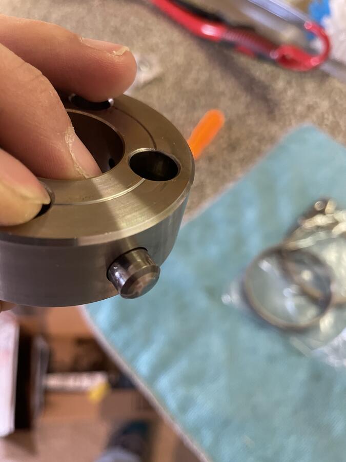

    pump piston
    Click image for larger version  Name:	IMG_0660.JPG Views:	0 Size:	47.5 KB ID:	89160
    If you cap the inner side of the hole, and push the piston, it springs back meaning this is sealed interface once the piston is in
    Click image for larger version  Name:	IMG_0661.JPG Views:	0 Size:	75.9 KB ID:	89161
    ANY tolerance deviation from OE would make the pump to show losses, Raj said his side holes are tighter, well, that can cause the pistons to bind and not create a pumping pulse, there must be a tiny clearance also for lubrication, or the pistons and disc would just wear out. same with the interface to the shaft. this is why I think the best is to stick to your original set as those items have broken-in together. without a CMM dimensional report showing OE vs Beisan it is impossible to say if they are similar, or one is better to the other, I bet engineers spent many hours defining the right tolerances and clearance for the pump to work effectively. so deviating from the OE design may have consequences unless there is testing data that shows improvement in performance without durability impacts.

      So i have come fascinated by how this thins works and love the tech chat on it, so here are some photos for those interested in learning about this thing.

      pump piston
      Awesome, thanks you for taking the time to post these images. I wish individual vanos parts could be had, I would buy a new disc (to be re-drilled), pump disc pistons/springs/cups.
      I wonder if there would be an effective way to measure the piston holes on the inside of the disc in regards to their postion top to bottom vs OE disc and also diameters vs OE disc.
      I also wonder if maybe the OE disc had any kind of tapered/chamfered surfaces where the small "inner hole" turns into the "piston chamber", that may not make sense. Also I suppose it would not be anything but flat in that area as the cup or "nipple" piece must rest flat in there.
      Basically wondering if there might be some type of transition in the surface between the small inner hole and where it widens out. I suppose it's just a small hole on the inside and a bigger hole on the other side to allow for the piston. It's just that any deviations to the machine process could have consequences when you consider all the intricacies of fluid dynamics etc. in relation to the function of this vanos system.
      I would imagine that Raj had to pressure tested these pumps vs OE before selling them no?

            Weight changes and redrilled holes should not affect the pumping mechanism. As far as I understand, oil is pulled into the pistons as those come out of the bores and when those get compressed (the disk is off center so as it spins the pistons get pushed in) high pressure oil is shot out of the pump. Weight will affect moment of inertia, but the disk is solidly coupled to the exhaust cam. So even though holes will (very slightly) decrease the rotational inertia of the engine internals, the speed of the disk is still directly controlled by the cam speed.
            The only thing that would affect pumping is what mau has pointed out. Smaller/bigger piston bores and different geometry in the veins that connect the cylinders to the pump output will definitely affect the volume of fluid that can be pumped with each revolution.
              Cool teardown and explanation, love this kind of stuff
              Although, it seems like nobody has had these kinds of problems using the re-drilled OE disks (which aren't matched to the rest of the components they're being installed with, but are manufactured to OE design and tolerances) that Raj had been supplying up until switching to his proprietary disks. While I appreciate the point that in theory it's best that you keep the parts that have all worn together, in practice it seems like the most important thing is simply OE design and tolerances vs not.
