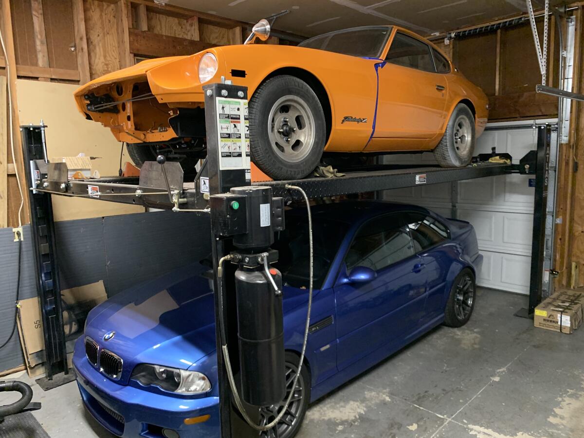

    If you only have one left, I think a 4 post plus a rolling jack or quick jack is the best option. Having a 4 post lets you stack cars for parking, makes wheels on work (fluid changes, etc), and makes it possible to do anything that required the car to be preloaded. 2 posts have some things there better at, but if you can only have one lift... I think a 4 post is the way to go.
    I used to have a 2 post. My current setup is as below. I'll be recreating my current setup at the house I'm building right now.

    .. that said, at my new house I'm going to have a 2 bay shop. I'm debating if the second lift should be another 4 post, or a 2 post to have one of each...
              Is that a quick jack on top of a 4 post? Quick jacks are great. But would prefer a 4 post or 2 post though as they are still not as easy of driving up to the lift and raising the car.

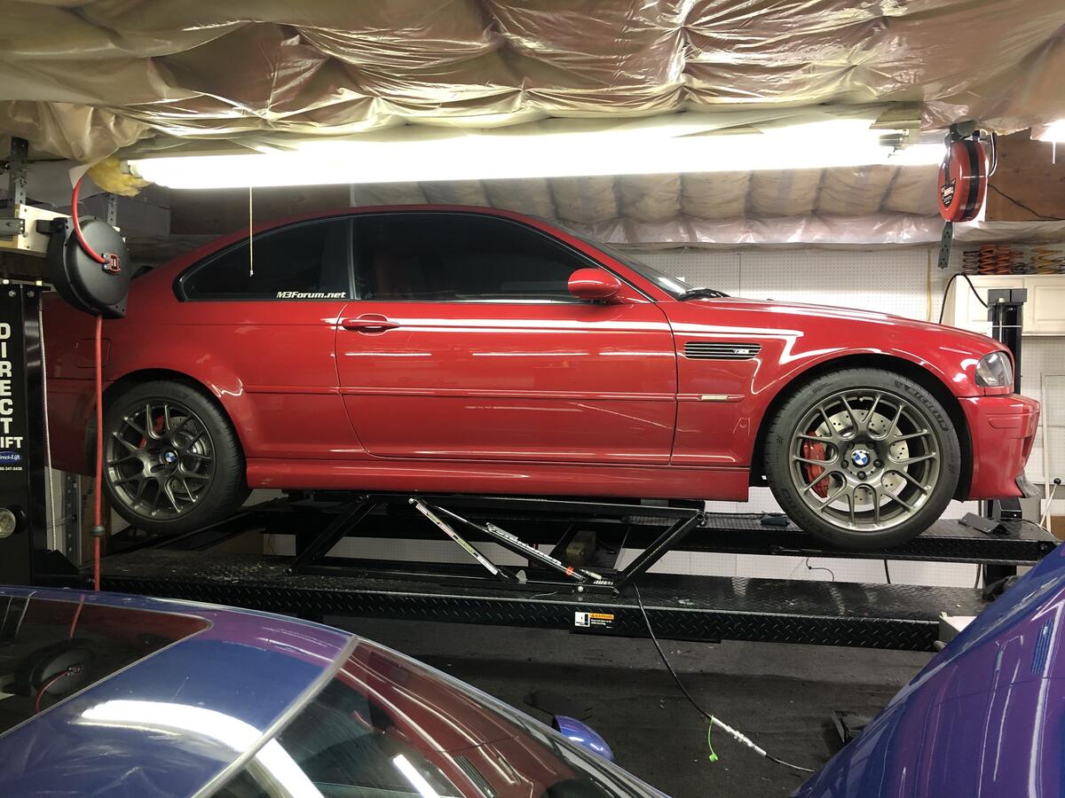

                  From a maintenance standpoint, most of it is easier with a 4 post. You just drive on and lift the car-- no careful positioning of the car and/or arms, or jacking the car to fit the arms under (if you're lowered).
                  The only maintenance I can think of that was easier on my 2 post than my 4 post was brake stuff. Even then, sticking the quick jack in isn't particularly more work than positioning the arms used to be.
                  Other than that, 4 post is easier for maintenance. Fluid changes are way easier, cooling system stuff is easier, and most suspension stuff needs preload-- so also easier.

                  It's a "Direct Lift", but I don't necessarily recommend it-- came with the house.

                      I contemplated this for a long time, eventually went with a 4-post due to ability to store the car under, and not having to worry about suspension hanging. The only thing you can't do on a 4-post is some suspension work, but with a setup like Ians' - there is no limit. I loved my Atlas HD8000 so much, I bought second one.
