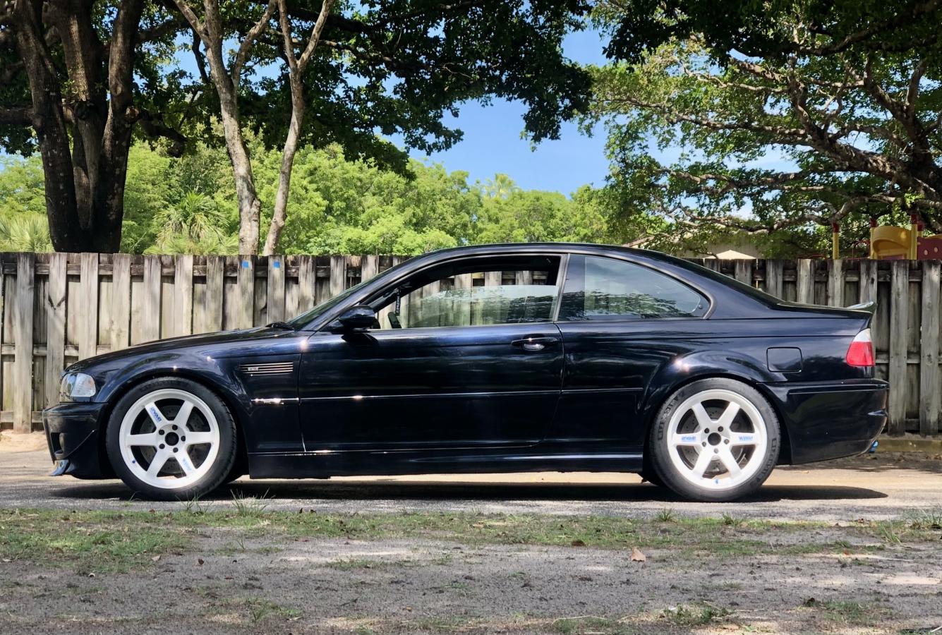

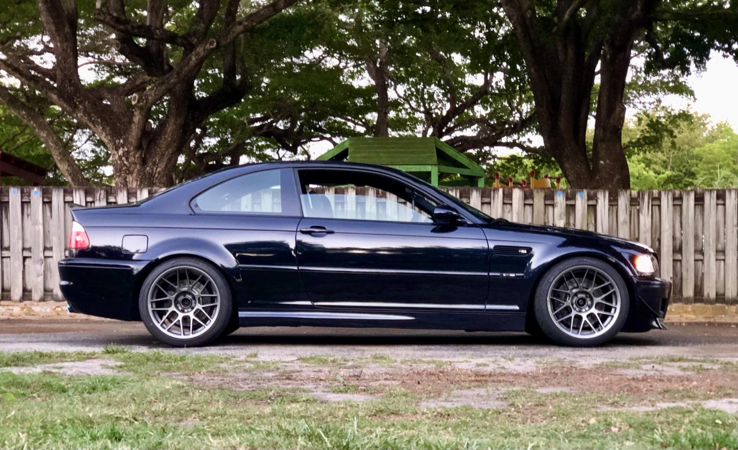

                    PS: here’s a couple side pics of the rake, if anyone was curious. Lol full on drag car spec, granted on the TE37s I did botch my tire sizing and the rear tire is just slightly taller so it looks slightly worse. The Apex are 265/35 square all around. Again maybe I'm just crazy ha!

                            I think the car looks fantastic as is and nicely balanced. Leave it alone?

                              Thanks! And yeah I should probably leave it alone and stop messing with the rear suspension so many times, I've already taken out the springs to adjust them with different pads, heights, etc so many times I don't even want to say 😅
                              And yup good point about the motion ratio with separate springs and dampers height adjustment! Wasn't common knowledge to me before, so found that out myself when I would try dialing the rear height after installing the PSS10s and losing my mind when i would measure the amount I moved the rear height adjusters, and then putting the car down the resulting ride height would change like 1.5x that amount ha.
                              Thanks again for the input everyone, I might just remove the rear 5mm upper spring pads, and will raise the fronts a few threads to 13.5" and call it a day.
