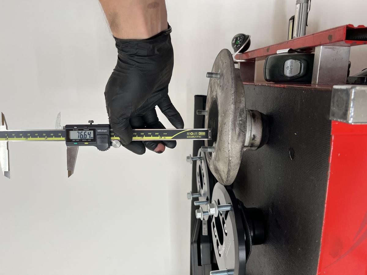

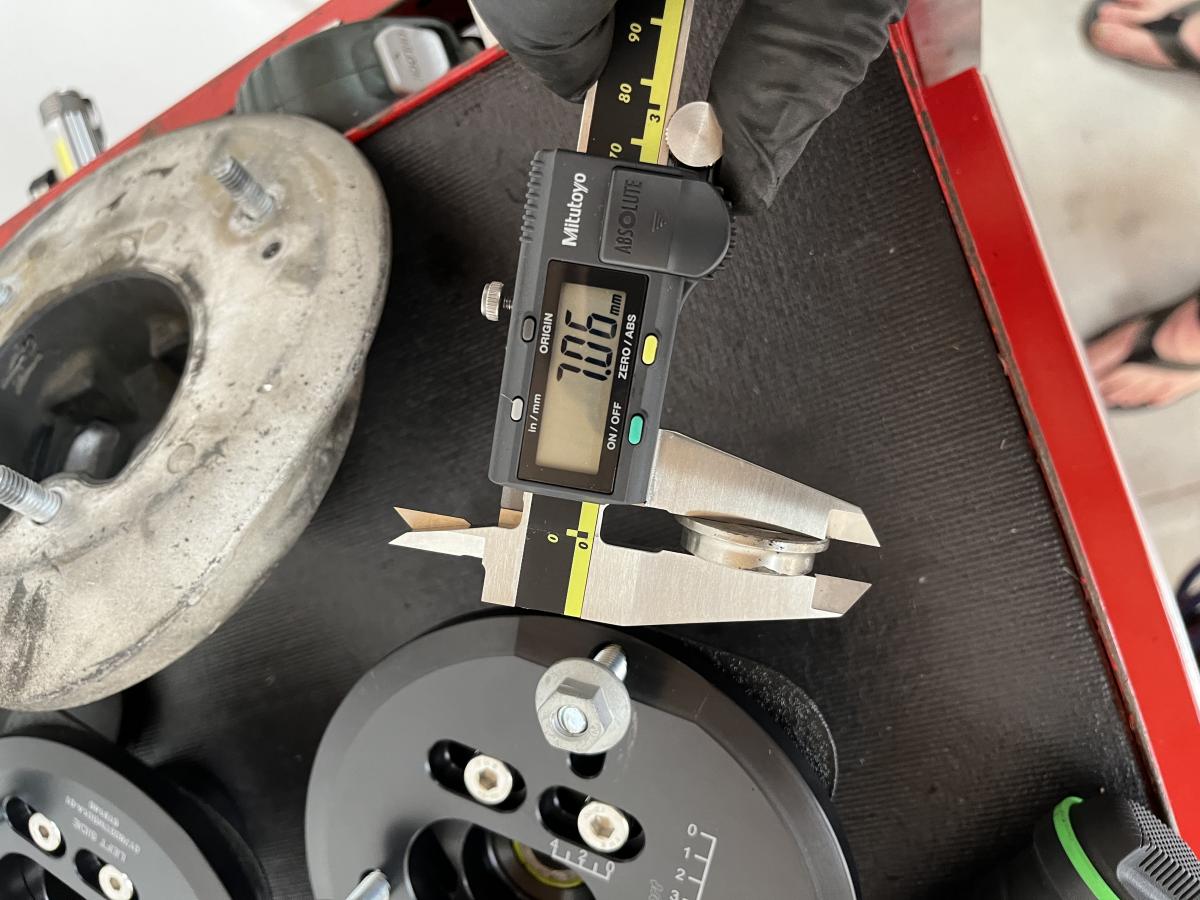

                The Turner plates give you just under 10mm extra travel. Not a whole lot! I just spent a bunch of time measuring mine this weekend Ground Control might be better
                edit: Does anyone in here have stack measurements for Ground Control? Pics of stock and Turner (add the spacer for Turner numbers)
                  Yes, I actually just finished taking measurements of new OE strut mounts, Turner Street, Ground Control Street, and Turner Hybrid mounts. Besides stock, Turner Street is the worst for bump travel (especially with the spacer). Turner Hybrid is the king. I'm putting the information together for a separate post.

                            I forgot to mention that several people have reported that out of the box, B6 dampers have less (bump) travel than the other twin-tube (stock, Koni, B4, etc.) options available. So between the Eibach lowering springs and B6 reduced bump travel, you would be correct. I have a B12 kit on the bench, but I haven't gotten around to taking measurements of it yet.
