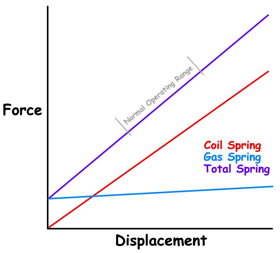

                              I tried to make an simplified graph to explain it. This is what the spring force diagram would look like for a shock with a linear spring with no preload, and a gas pressure from the shock.
                              By pressing on the shock on a scale, you are fighting against the gas spring (which is very real and can take 100+lbs to overcome). But once you do overcome that force (such as the weight of the car), the only additional force required to move is from friction.

                                Pretty much what I thought – i.e. the gas force "has to be overcome" in the same sense as a spring's force has to be overcome. So we could say the gas pressure functions like adding a bit of both rate and preload to the spring, all of which could be fully compensated by taking some of those out of the spring itself. Accurate?
