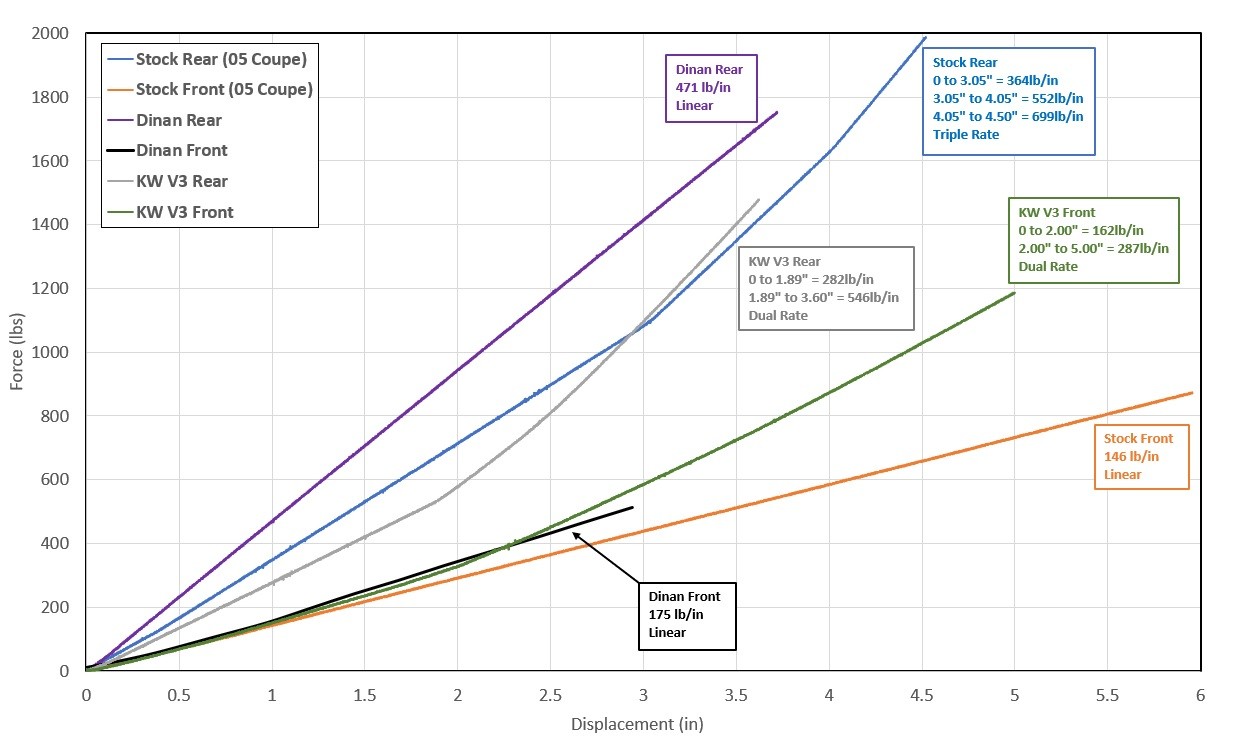

        A couple things to consider when trying to maximize bump travel:
        1. You may have limited travel due to shock length and top mount height, but your wheel/tire might crash first so it's a good idea to check. The way I did this was remove the spring and bump stops and move the wheel through its travel then turn the wheel side to side a little bit (90-180 degrees at the steering wheel in either direction). From here you can measure and see what the limiting factor is. With my 18x8.5et38 with 245/40 tires, which is pretty conservative and not terribly flush, this was 11.5 inches wheel center to fender. So I would benefit from gaining about 1" of bump travel from the Koni or stock shock.
        2. Of course this is complicated because the front springs are so soft, they really rely on the bump stops as an added spring to support when cornering. Careful about adding too much bump travel without also increasing spring rate. It might end up being a terrible handling setup. As Obioban said in the original post, stock springs are 143lbs/in! Dinans are still only 175! When I was running 300's without the support of bump stops, it still felt soft but with so much more linearity and predictability.
        Moral of the story is - it very quickly makes sense to go to "coilovers" on this car if you start tweaking things and you want the ideal balance of performance and comfort.

          I think stock springs are 143lb/in. Eibach pro-kit is 155. But good points!
            Yes, my bad.
