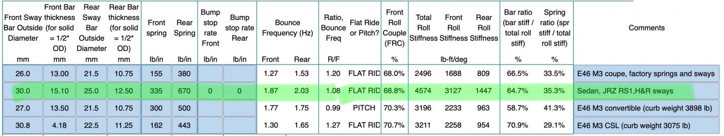

                          Been reading and learning about flat ride all weekend. Just finished all 25 pages here among others.
                          You seem to have gone down a very similar path and asked the same questions I have had going through all of it.
                          Bought a set of TCK D/A with 400/500 as recommended by Mr. Kline. Is a dedicated track car that sees some backup-daily usage. 3350lb no driver. 50% corner balanced. Looking into flat ride info and had a few questions about your journey.
                          I see you went down the path of TCK S/A with ~350 and ~700. Said it was pretty bumpy? Did some adjustments and didn't really hear if it helped? Think you even debated getting D/A rears it seems.
                          You also inquired about why TCK recommended the 400/500 to you (My setup). Without much further forum discussion. Just trying to see what angle he has vs the flat ride mentality. If you ever maybe discussed that elsewhere.
                          Curious where you landed after all this time. Did you get the original 350/700 setup to work?
                          Did you end up happy with the outcome after doing flat ride on the tck?
                          Just looking for some tips. Literally just did my corner balance and yearly alignment last month. Kinda wish I had learned all this before that! lol. My car has felt great the last few track days but now this has me intrigued.

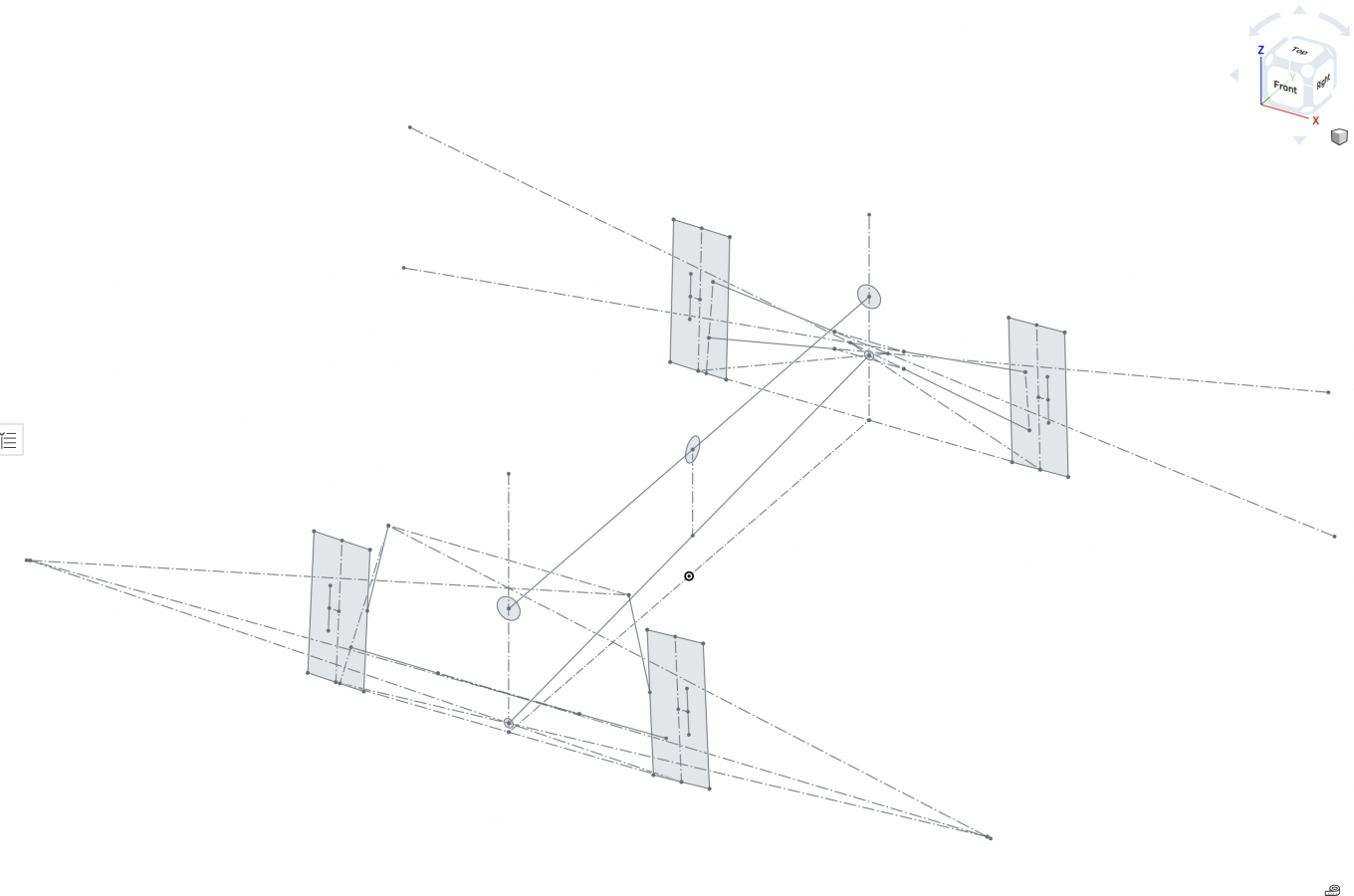

                            I've been detailing a bunch of suspension geometry modeling work in my build thread here - it's ready enough to share with folks here if you're interested in really getting your suspension right. If you're lowering the car, especially if you're lowering the front, it's easy to mess the balance up.
                            Simplified CAD model of the e46 M3 suspension: https://cad.onshape.com/documents/a1...66f543dbff2801
                            Click image for larger version  Name:	Suspension model.png Views:	0 Size:	476.0 KB ID:	216790

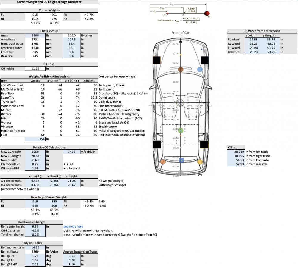

                            CG and roll modeling in attached excel ( CG location change_332it.xlsx ):
                            Click image for larger version  Name:	Chassis roll 332it-bigger sways.png Views:	31 Size:	594.6 KB ID:	216795

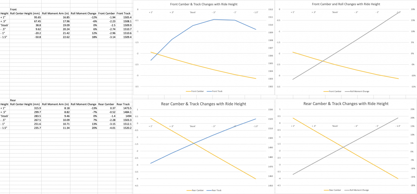

                            As well as modeling suspension curves for different height settings:
                            Click image for larger version  Name:	Suspension Curves.png Views:	0 Size:	345.1 KB ID:	216791
                              CG and roll modeling in attached excel (CG location change_332it.xlsx):
