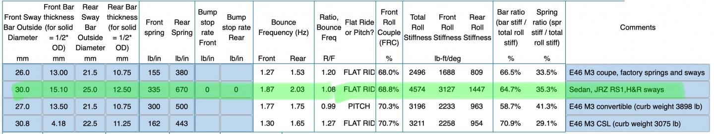

                          Hey guys,
                          I have a car that I got pre-modded that I'd like to dial in more to my liking.
                          As is the handling is a bit interesting to say the least. The rear end has almost incredible traction and tractability out of a turn however the front end gives up much too early. It's not balanced. The car is also much too low.
                          What I want/like: a strong front end and oversteer tendencies if I overcook it. Not sure if that qualifies as neutral-ish.
                          Hardware:
                          JRZ RS One
                          Swift springs 100F (+ helper) / 120R (+ tender rate unknown)
                          H&R sway bars (F soft, R stiff)
                          ​​GC adjustable end links
                          Rates translate to ~558lb and ~670lb
                          Would dropping the front spring to 6kg (~335lb) be a good move?
                            I think so. I'm not too familiar with the JRZs, but bump stops are stiff springs, so if you're on the bump stops, your front spring rate is effectively higher and will contribute to understeer.
                            Maybe you also have something else going on like worn components, bad alignment or crap tires.
                            2003 Imola Red M3 w/ SMG
                              kaiv yes dropping the front rate and doing stiff front and soft rear sway bars.
                                I'm going to have my JRZ RS Ones sent out for rebuilding as well so this has crossed my mind. Currently 450lb/550lb. per the calculator, i should be going to 300lb front if i leave it at 550 rear. There's a likely need to change spring lengths as well, right?
