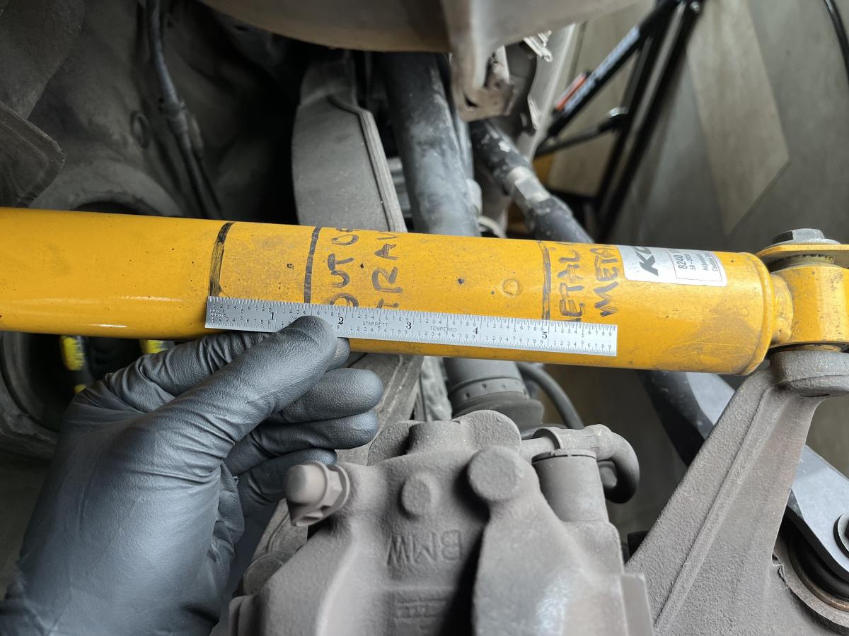

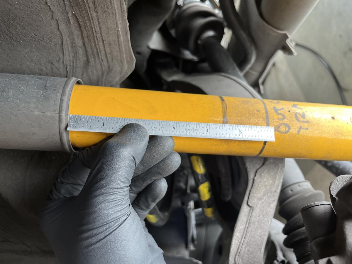

              Z4M shocks have 5in of travel. I compared the stock v h and r and travel wise they were the same. So lowering the car just ate travel. I think e46 have also 5in of total strut travel.
                Stock e46 M3 rear has 4.5” droop, 5” bump, 1.4” until contacting the bump stop

                      I was referring to the fronts. Then i noted i used the wrong terminology. I meant struts
                      for the rear, the B8 were a good 25mm shorter. So droop was the same shorter
                      i will find some photos a they can be of use to some

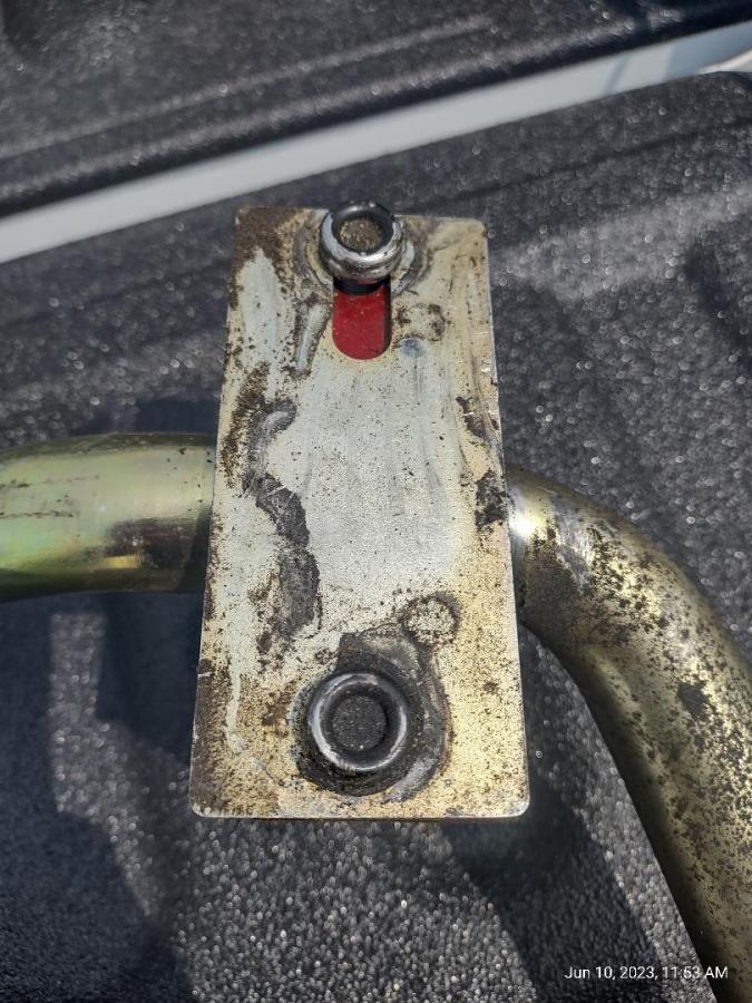

                          If you go bigger sway bars, may I suggest you reinforce the sway bar mounting area with Bimmerworld's reinforcement kit (https://www.bimmerworld.com/BimmerWo...i-330i-M3.html). Just a thought after last weekend.
                            Feff
                            Yikes!
                              Yikes!
                              This is a common know failure yours truly did not know about. The learning curve never ends. 🤑
