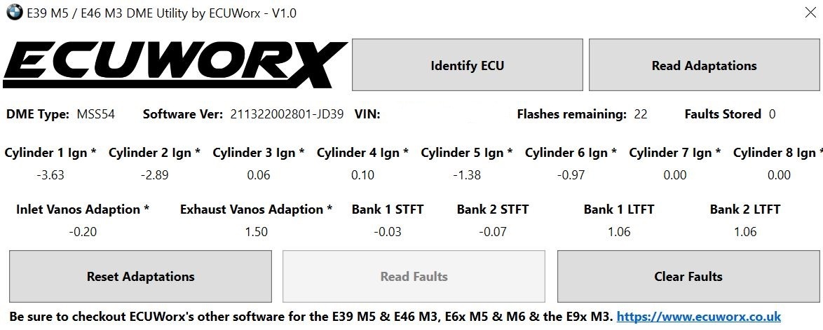

    What is the acceptable range for the ignition adaptation values that are reported by the ECUworx tool? Great tool by the way. Thanks Martyn! My understanding is that negative values represent the number of degrees of ignition timing that the ECU is pulling (retarding ignition). To my knowledge, pulling ignition timing is not good for power, so do large negative values indicate that there is an issue? Without knowing more, I would assume that ignition adaptation values of zero would be ideal, but what can I change to move these values in the correct direction? Below are my current values, but i've seen cyl 2 as high as -4.9, which seems like a lot.

      I believe this is referring to the valve timing that the VANOS unit controls (camshaft advance and retard). It seems that the VANOS valve timing adaptation values have been discussed, but i cant find much info on the ignition timing (spark advance and retard) other than this post from the same thread:
      Essentially they're knock adaptions. Negative numbers means that much timing is pulled, positive numbers mean that much timing is added to whatever the final calculated desired spark advance is.
      It sounds like these values indicate how much the spark timing is deviating from the ignition map due to knock, but I dont have a good sense of what values of knock adaptations are normal. To me, 5 degrees of ignition retard on one cylinder seems like a lot, especially when other cylinders are close to zero, but i'm hoping this group can provides some insight on this.
        Yea i agree with you... for what its worth, all my cylinders are at - high 3s/ low 4s. 170k mile engine running on Texas 93 octane. VANOS rebuilt 3k miles ago.
          Anyone else? On my new car, I'm getting around -4 across all 6 cyl. All plugs and coil are new. New fuel filter, fresh gas. Stock ecu, no mods at all. Car runs well, but I feel like there's more. I'm trying to think of what else to change. Precat o2s will be done soon.

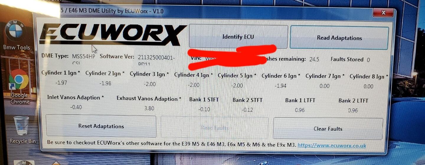

                -2° seems a bit too much for an otherwise healthy engine with rebuilt vanos, new plugs, 67K. I wish I knew what was considered "normal" as well and what to drill down on to change this condition.
