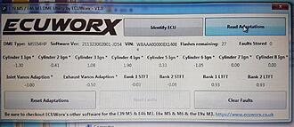

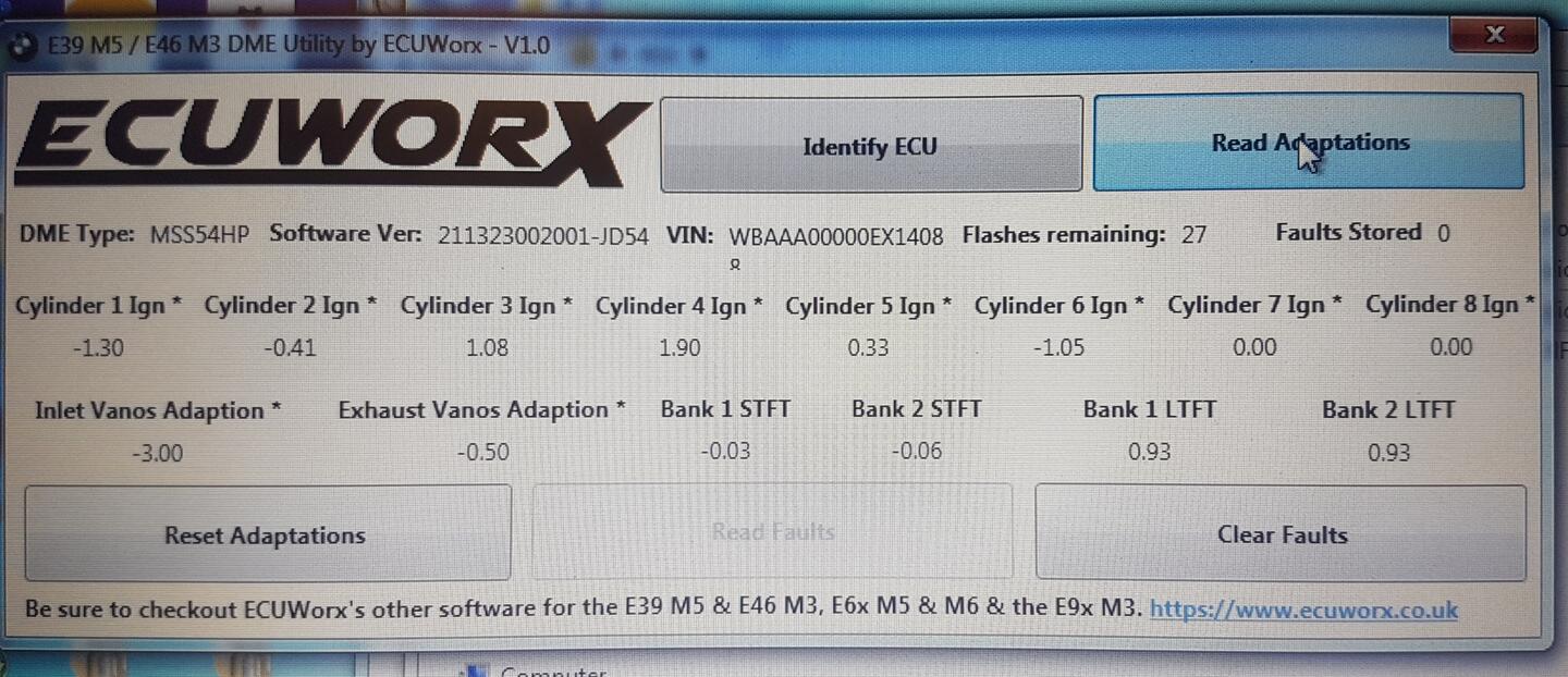

                          Here's my readout. Anybody knowledgeable care to comment on the Vanos adaptation values? Vanos overhaul has not been done on this car. The ignition retard is unfortunate, but i didn't expect much because Canadian gas here sucks anyway.
                            #43
ID:	23982 Here's my readout
                            We welcome any useful information about my readings, vanos have never been worked on. and do not have any issues on car running
                            Click image for larger version  Name:	20200511_231456.jpg Views:	0 Size:	154.1 KB ID:	23630
                              #44
                              Originally posted by Ahmed.Alghoul View Post
                              Here's my readout
                              did reset adaptation
                              I took the car for half-hour driving and re-read the adaptation
                              Click image for larger version  Name:	after vanos readaptation .jpg Views:	0 Size:	83.9 KB ID:	23981
                              Martyn,​
                              I hope you'll give us minutes of your time with thanks to explaining the best Vanos values ​​to us, and when we can say that we have Vanos issue
                                #45
                                Ha, this is why in my line of work they say not to order a test unless you're specifically looking for something.
                                The VANOS adaption is just how much the DME needs to adjust the cam by to get the timing right. If the timing was 100% perfect, the adaptions would be zero. But getting it 100% perfect is pretty rare - there are tolerances built into all this. As long as the timing is within +/- 8º of the target, the DME can adapt to it. If everything is driving fine, and there are no errors suggesting the vanos isn't able to adapt, then there's nothing to worry about.
