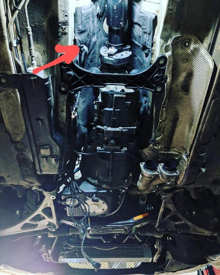

          I'm referring to the black thin-ish (maybe 10mm thick?) One that goes between the transmission and the transmission tunnel.

                do you mean on the exterior? If so then yes those are there. I have a feeling the one behind the dash is there also but I need to check again. From my photo archive one of the photo shows it missing but it might have been removed for photographing purposes.
                    Yeah on the bottom of the car. Here's the best image I could find of it with a quick search:
