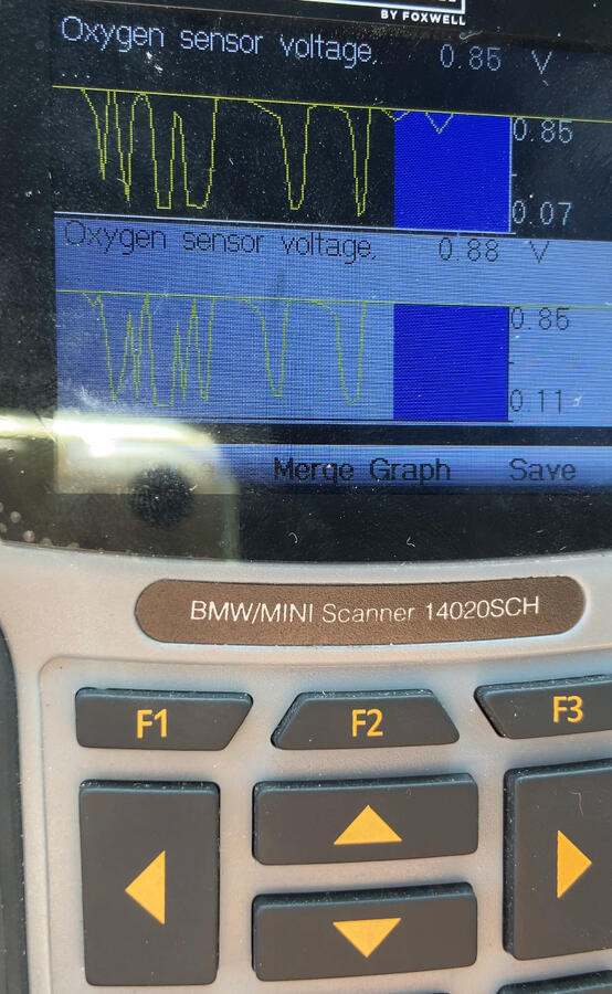

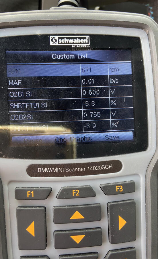

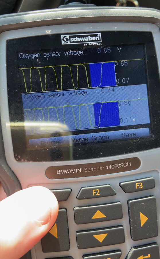

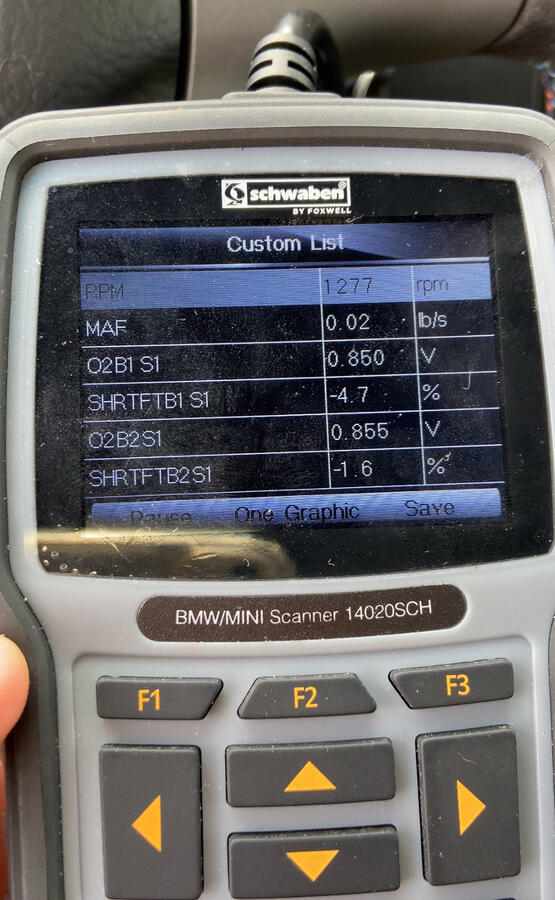

                So I'm not sure which sensors I should be tracking, but I was messing around with the Schwaben scanner and recorded this.
                O2 sensors pre-cat graph during normal idle:

                O2 sensors pre-cat graph during misfiring:

                Few sensors during normal idle:

                Few sensors during misfire:

                  Did you ever resolve the issue?
                    I didn't followed this thread due to a time gap. But it's pretty useless to show a snap shot of the O2 voltages and the STFT. These data should be logged for at least 30 sec with one sample per second. Also include the LTFT. The MAF unit should be in gram/sec as LBS is too low resolution to tell a difference off bad vs good.
