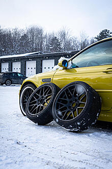

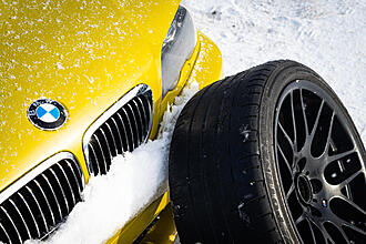

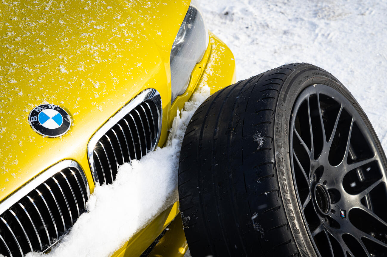

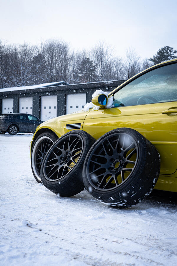

    Took another step towards this project today. Received the OEM wheels to begin with. We’ll be exploring the possibility of doing 18s.
    No paint was damaged in making these pictures 🤪
