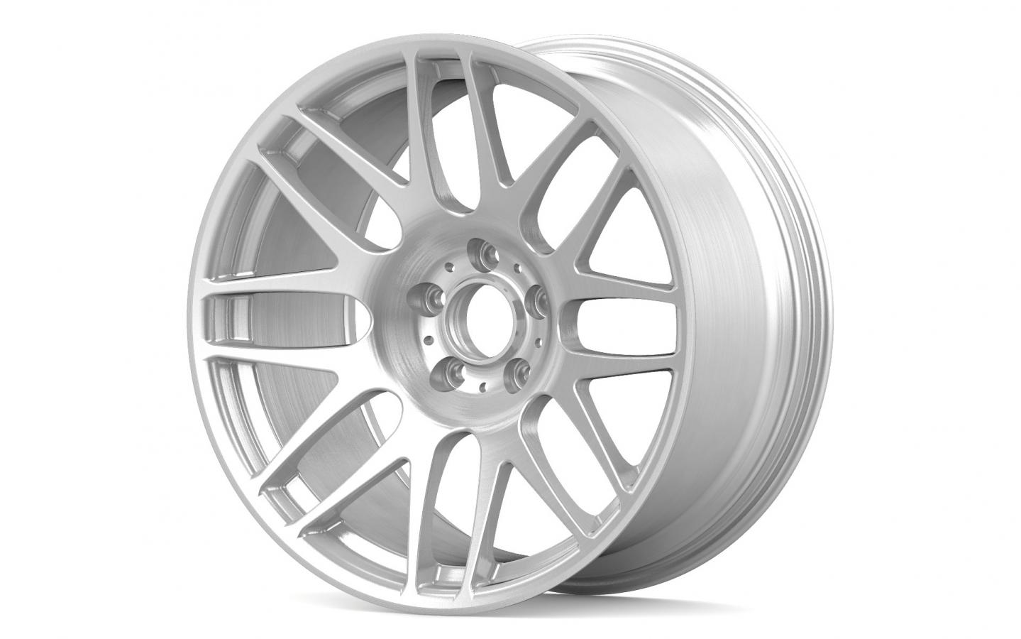

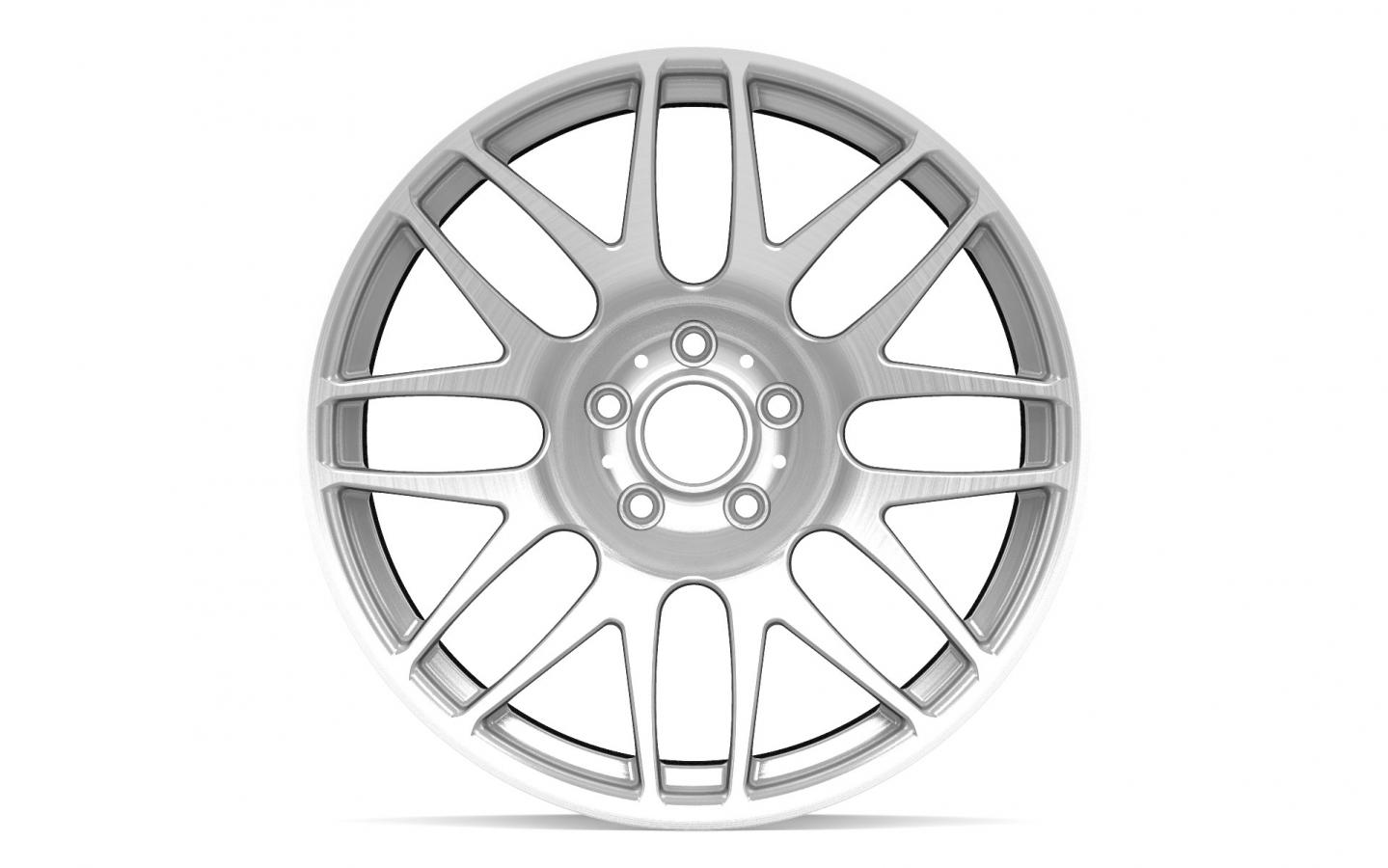

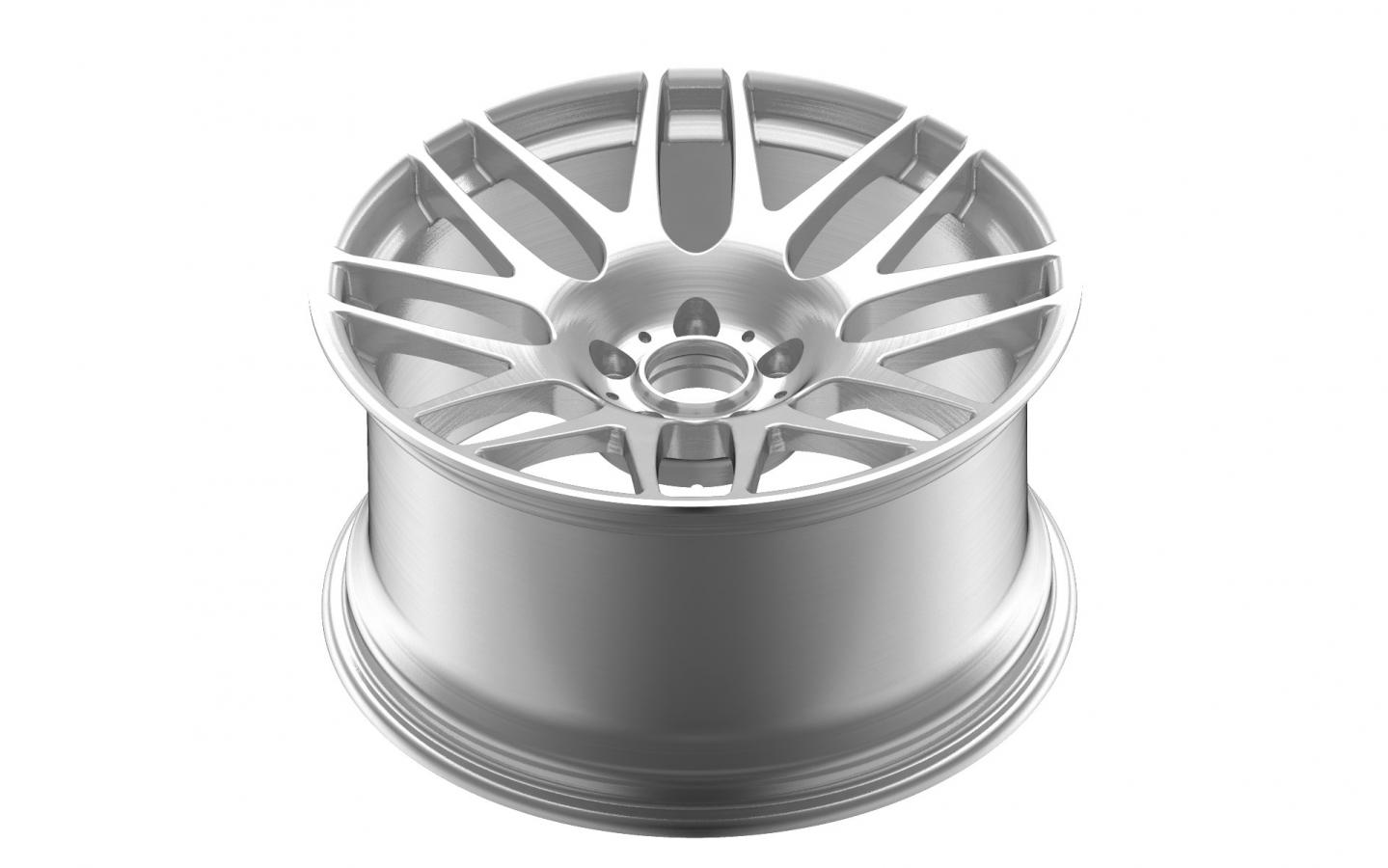

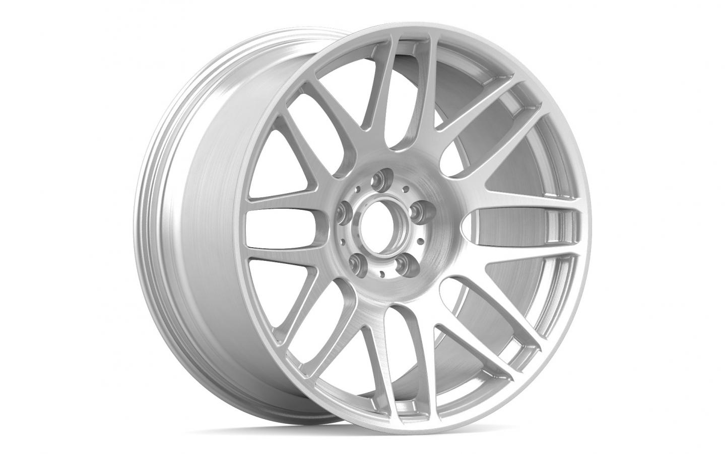

                              At 1600kg load rating, it was about the same weight as the OEM flow formed rear wheels which are 19x9.5J ET27 at roughly 11.x kgs / 25.x lbs from looking up online. I need to actually weigh it to validate.
                              I'd like a 1800kg load rating to be bend-proof on the streets considering these are commissioned to specs per build. There won't be off-the-shelf inventory as most have their own fitment goals without spacers.​
                              See below for the 19x10J ET15 render. This wasn't the final one as a few corrections needed to be done and some features were missing.
                              Click image for larger version  Name:	163M-19x10-003.jpg Views:	6 Size:	82.7 KB ID:	229909
